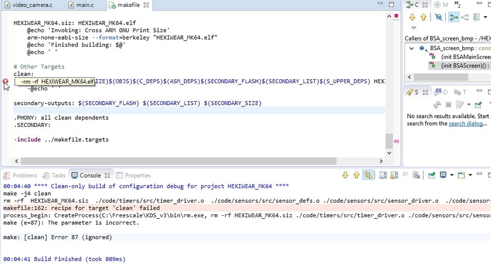

Hi All,
I am getting the following error when I tried to clean my HEXIWEAR project:
Looks like it is complained about .elf file. Have someone experienced the same problem? Any idea how to solve it?

I am using KDS Version: 3.2.0 + GitHUB + Gitkraken. I could clean and built the project before without issues, but after I checked out previews revision code, I start to get this problem.
My real problem is that I do modification in the code but then when I try to debug I don't see the changes, Its like is using and old built's file (or the built's files are not updated). And I suspect that its happend because of this issue with the cleaning.

BlackNight
Hi Ivan,
if you delete the .elf, then it only will do a relink, not a complete build of all files.
You would have to delete all the object files too.
Erich

BlackNight
yes. The simplest thing would be that you delete the whole 'debug' output folder.
11,544 Views
BlackNight
Hi Ivan,
Are you using KDS V3.2.0? From what I know is that the problem comes from the very long command line passed to the rm command: the make file is able to deal with command line length >8192 on Windows, but not the rm command. So it fails.
I have submitted a report in GNU  ARM Eclipse, but to my understanding this is not fixed/improved yet.
The easiest workaround is to delete the files in the output (debug) folder directly in the IDE or on the disk if you need to have them cleaned. Otherwise you could ignore that message.
