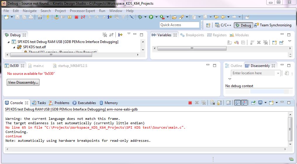

I am trying to do some basic tests using the new KDS v1.1.0 and am getting some strange errors.  (See attached)  Any ideas on why this error is happening?

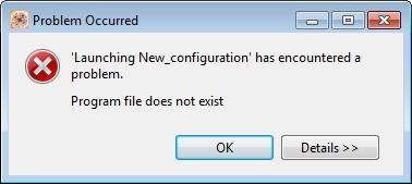

However, it will still report an error to debug and complains about the "program file does not exist":

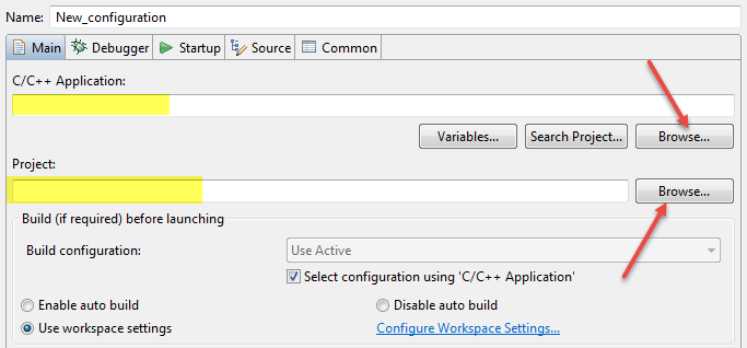

Actually, it is not that the program file does not exist: it cannot find it because not specified:
specifient the project name and .elf file then allows debugging it.
Maybe this has been your problem?

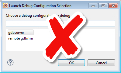

I don't have Team Viewer. But I think I see what you mean:
You had this dialog, but the sad thing with GDB is that this is a dead end does not work: you cannot select the debug configuration that way :-(
Yes, yes, yes, that's weird :smileysad:.
Instead, select the debug configuration from the drop down, or from the launch configs.
I tried to explain these kind of Eclipse/gdb-isms in GDB Debugging with Kinetis Design Studio, so you might go through that one if not already done.

BlackNight
Just to be sure: that screen shot shows me that it is running fine (stoped at main). But there is a left-over from another debug session ("no source file found") which you can close. So that looks ok?
24,433 Views
johnbaker
Yes, it does appear to keep running. I just copied a main.c bare board CodeWarrior source file to a new KDS project and ran it. I still get the ‘No source available’ error but it appears to be running just fine. It measures timings and the timings are different but that probably has to do with the KDS compiler optimizations which look different than CodeWarrior. I will continue using KDS now and see what happens.
