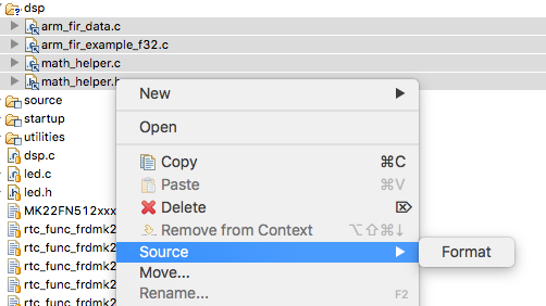

aerodame
What does the ? mean on a folder in the Project Explorer?  And what does it mean to "FORMAT" the source?

TICS_Fiona
Hello Stephen
Label Decorations are used by CVS to show important synchronization information about workspace resources.  The ‘?’ decoration on a file or folder icon indicates that the resource is not under version control.
Hope this helps!

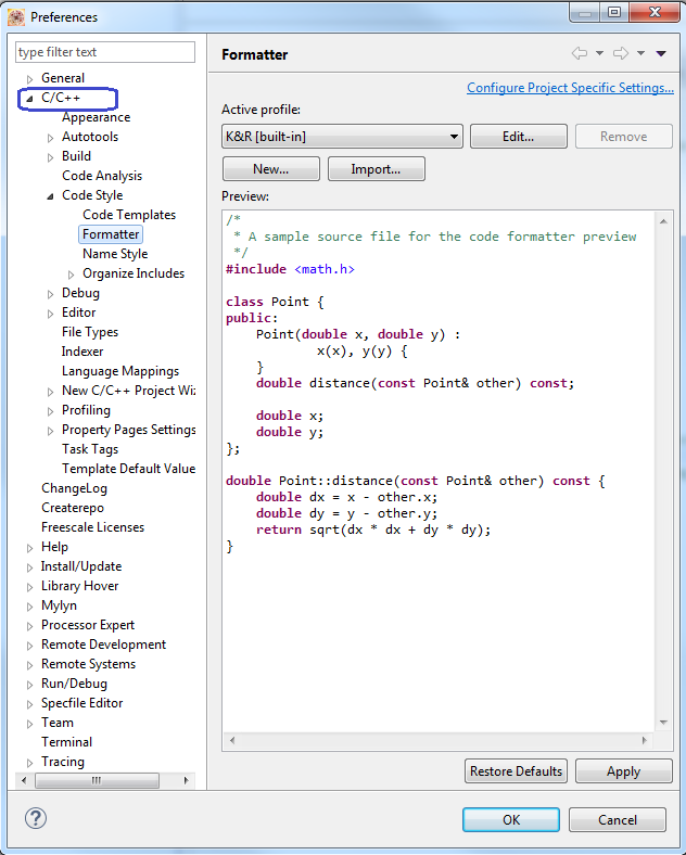

Also, to my second question.  What is the Format Source?

TICS_Fiona
Hello Stephen
I have no experience on GIT.   For version control problem, I think user only needs to check in the project folder, excluding ‘Debug’ subfolder.  The “.metadata” records the configurations for workspace, not for project, so “.metadata” can be excluded from version control.
The “Source->Format” commands applies the full  “C/C++ > Code Style > Formatter” preferences to the entire contents of the active editor, or to the selection if there is one.
