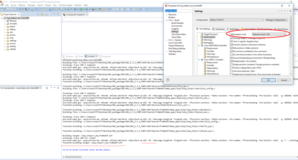

Hello Christie,
Could you please use the latest KSDKv2.3 ?
I  test the the demo "lwip_httpsrv_bm_frdmk66f" of SDKv2.3, set Optimization Level to -o3,
there is no error with build :
Hope it helps
TIC
