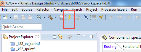

i want  to dump(LOAD) application firmware (.bin) code to FRDMK64 using KDS IDE Debug.
without MBED option is possible to load code using KDS IDE only? i think using DEBUG option we can do, but i dnt know how to do that one. we need any extra debugger device for that.
If debug possible mean how to do that one?

suppose if i have .elf or .hex means is possible? how to do that one.
and also mention which format?

you ca use either .elf or .s19 file to burn flash.
besides debugger, you can also use simple flash to burn elf or s19 to flash.
