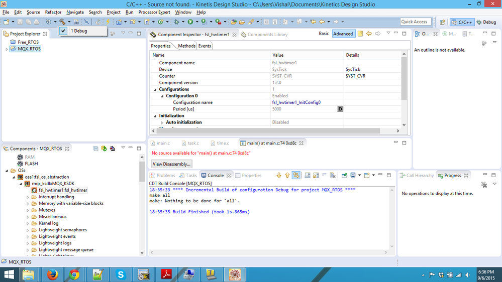

  I have been using KDS for almost a week. Today I tried to use MQX RTOS to and tried a very simple application. I could build in debug mode and run the program. But i do not see the Release button. Can some one please help me?

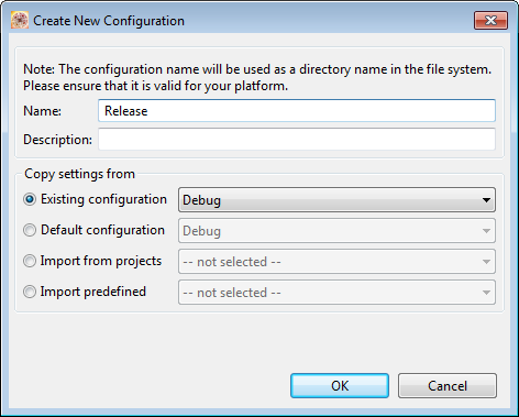

Have you copied the settings for the new configuration from the existing one?

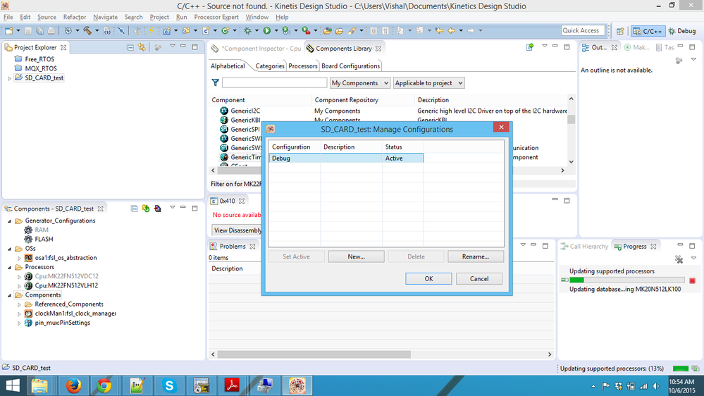

  When I go to Manage, I get the below settings
I go to New. The Existing configuration only has debug. It doesnot have release
Default Configuration has Debug and Release. I select Release from Default configuration.

BlackNight
Yes, my point is that you need to create a new configuration, with using an existing one (copy settings from existing configuration). The name itself does not matter of the configuration.

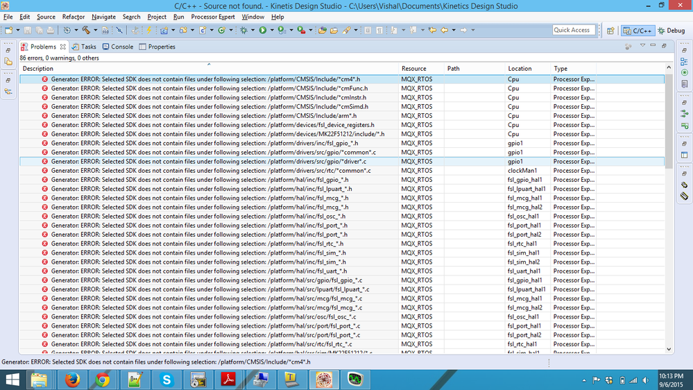

  I agree that there is a way to add Release from Manage. I am doing as follows.
Build Configuration -> manage
New
Default Configuration->Release
Name->Release
Set Active.
After this, when I try to build, I am getting error. But when I set Debug as active, the build goes through. Can you please help me?

Why would you expect such a 'Release' thing? In Embedded programming, there is no such thing like 'Release' or 'Debug' ;-)
These are actually build configurations. You can add your own build configuration with Build Configurations > Manage:
I hope this helps,
