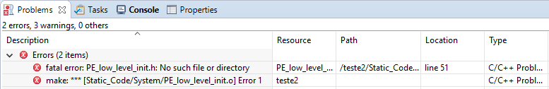

Hi everyone.
I'm having a problem (actually two) when compiling my project. When I do it, I get this message that you can see on the image below.

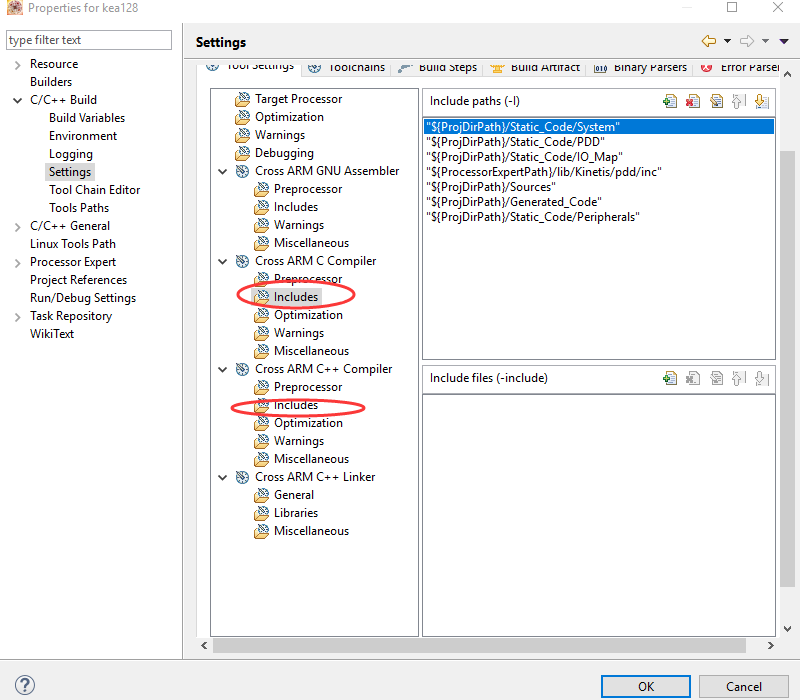

The first error, the file exist, but it is in another path. I tried to put it in the "correct" path. The error disappear, but appears the same error with another file. I also tried to look the includes of the compiler in Properties -> C/C++ Build -> Settings, and I guess that all the paths are there. And I ALSO tried to put ALL the .h files into ".../Static_Code/System", as the error says. But the problem persist.
The second error, I just don't know what to do.
Can you help me?
Thanks in advance.

Hi nícolasludwig,
I was having the same issue and I solve it changing the Project Location. It seems that KIDS can't handle some characters ("ñ" in my case). To be sure I also use a really short route.
Hope it helps.

Hello Nícolas Ludwig ,
Please check the two pathes as below :
If still can't work, you can send it to my , I will check it on my side .
Hope it helps

nícolasludwig
I put the two pathes, and still can't work.
I fixed the first error, and now just the second error persist (make *** [Static_code...).

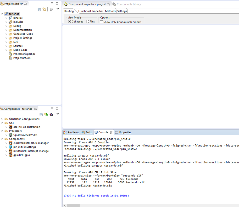

I build your project on my side, there is no error :
Alice
3,387 Views
