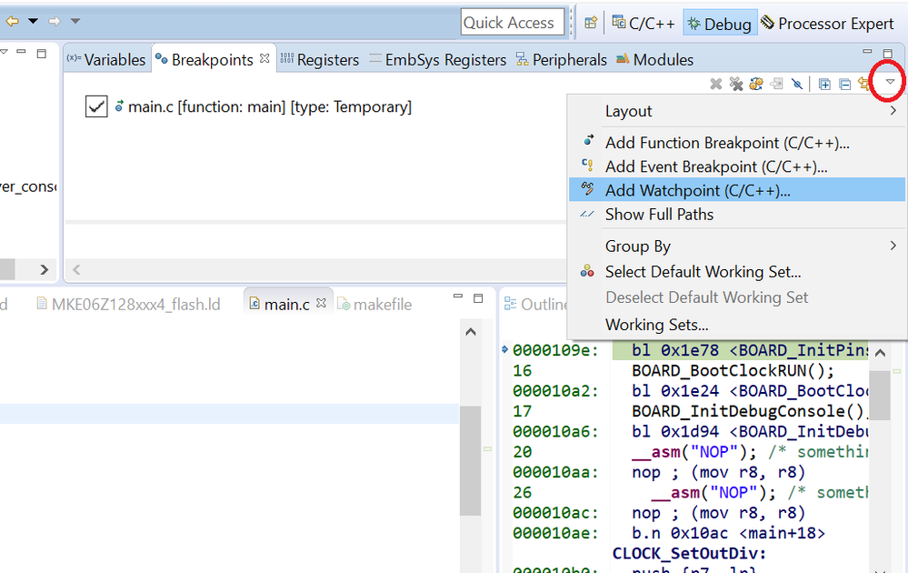

jingpan
You can use watchpoint function to trace the buffer/stack overflow.

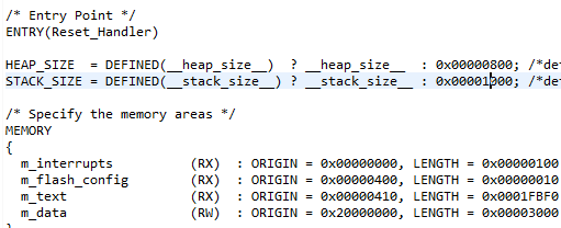

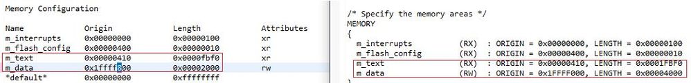

codyhubman
So I did check those values as far as I know. I'm curious if you might know why there are differences in the origin and length of these two. The left is the MAP file and the right is the LINKER file.
I am curious why the values of m_text and m_data are different between the two separate files.

codyhubman
Update:
I found out it was going to thee KE06Z64 linker instead of the KE06128 linker. I changed the linker files and got that squared away. I still keep seeming to drop into the handler when running my code. I seen something about faults caused by issues from the boundary of the Lower SRAM and the Upper SRAM.
In my memory I noticed before and after that boundary had abstract values. However, On the boundary of 0x20000000 there is a bunch of "?" marks that appear for a little before and after. Is this potentially why my program crashes and ends up in the default handler?
