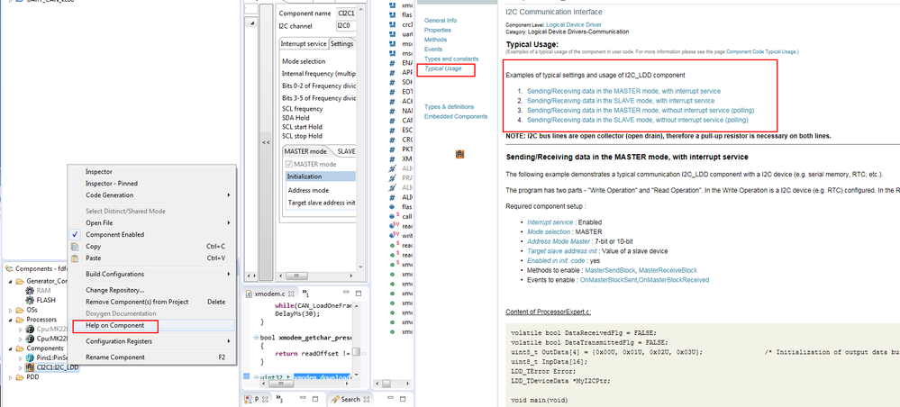

syed_idris
We didn't find any example for I2C component for external components connected to Kinetis with PE. while going through fsl_i2c component I am getting confuse between I2C mode selection as master or slave,this mode selection is as per controller side or device side?
means if I am connecting I2C component to Kinetis controller (Controller as master and device as slave) then I have to select I2C master mode, am I correct?
in component inspector for master mode we have to write address of slave?
where to define the slave data register which I want to read from slave?
I2C example with PE is also appreciated.

Hello syed,
Which chip do you used ?
I recommend you can fist check these basic demo code :
Hope it helps
Alice

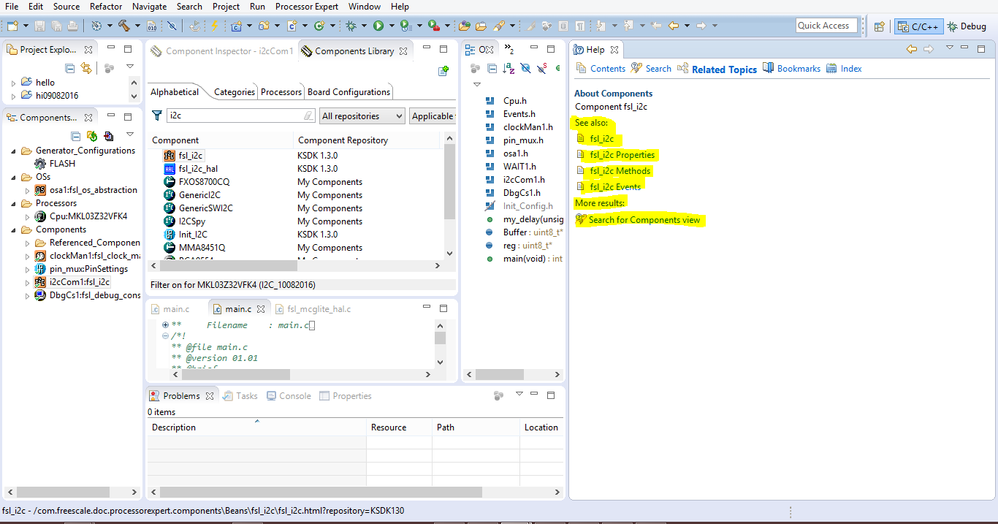

syed_idris
Hi Alice,
I am using KL03 chip and fsl_i2c component, and I didn't get that "typical usage" in "help on component"
Idris

Hello syed,
Yes, under KSDK , there is no PE demo, you can refer to
the sample under KSDK installation directory :
KSDK_1.3.0\examples\frdmkl03z\driver_examples\i2c
Hope it helps
Alice
