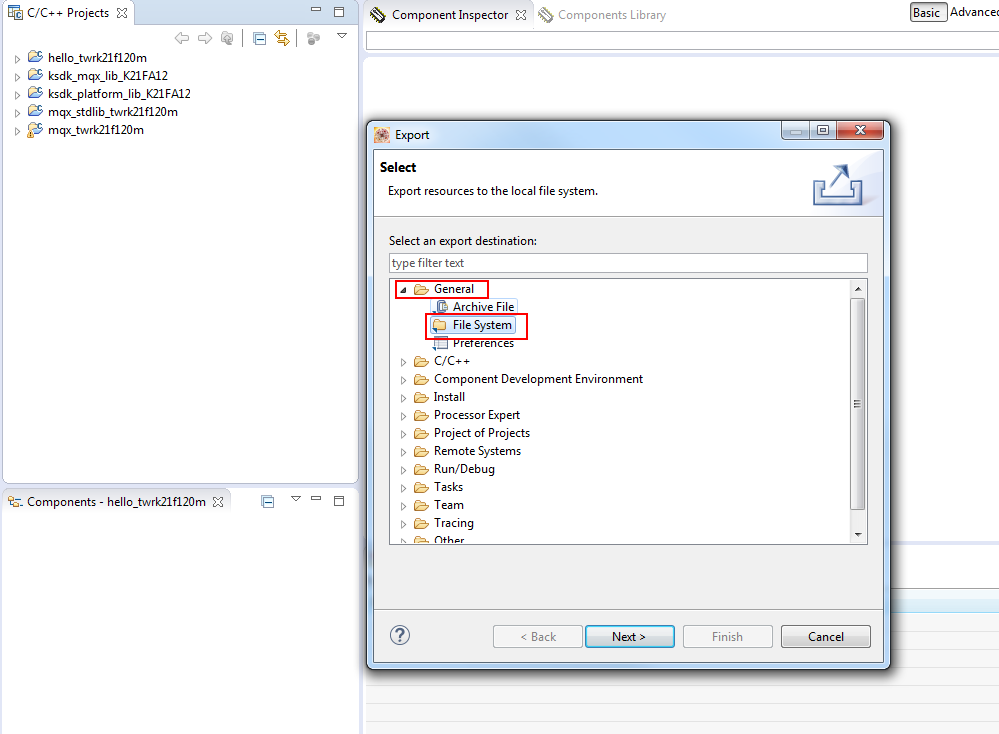

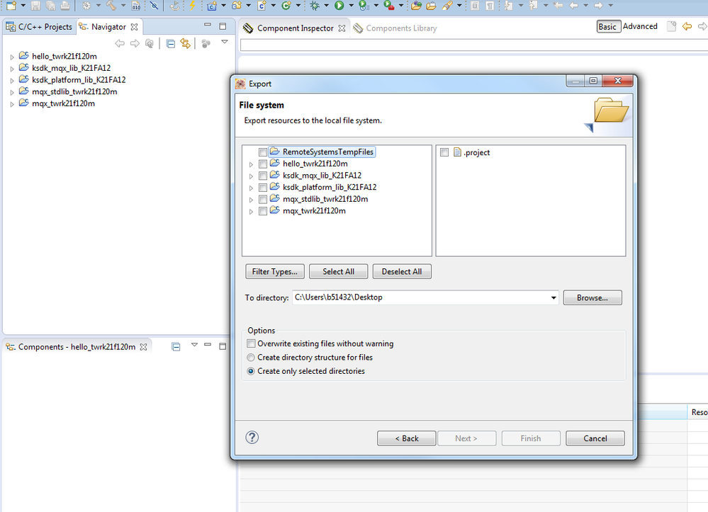

Hello Randy,
I have test on my side .
Please select General -> File System  :
Then you will see
Hope it helps
Alice
6,072 Views
randyhermes
Thank you Alice,
Following your instructions copies all of the project files to a new directory.
What I am trying to do is create a .wsd file that references all 4 of the projects I am using.
So I can Import the .wsd using project-of-projects and have the library projects and my project loaded into my workspace.
I guess the alternative would be to just create a new workspace and save it.  But I haven't found a way to do that yet.

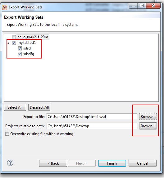

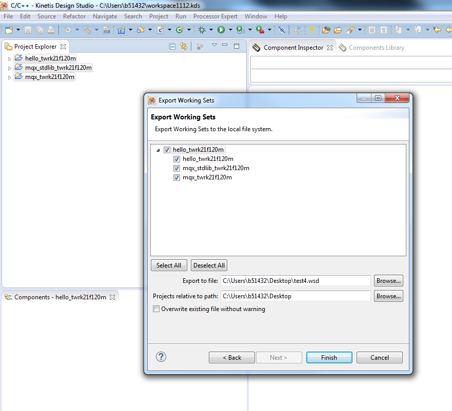

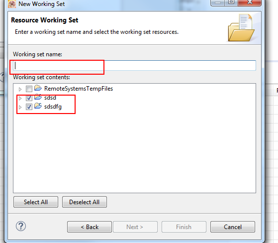

Hello Randy,
(1) I know your meaning , on my side , it can work well :
This mean the working set name is "hello_twrk21f120m" , it include three project (or lib) : hello_twrk21f120m  mqx_stdlib_twrk21f120m  and mqx_twrk21f120m.

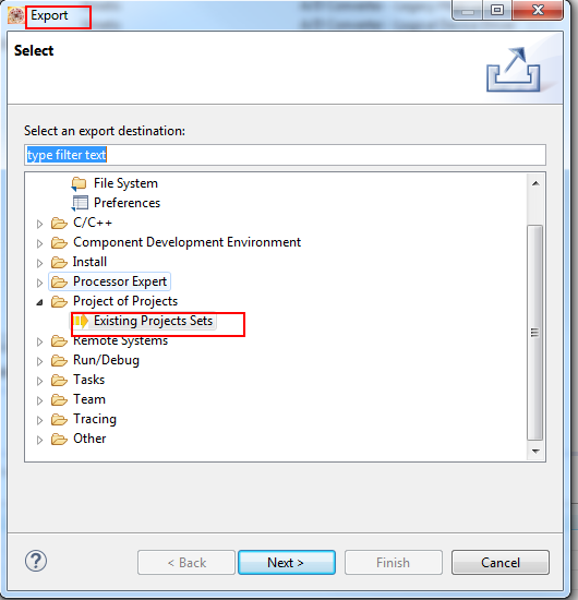

(2) If  you want create a .wsd file by your self , there have two steps :
  -  create a working set
  -  export the working set to .wsd file .
After this , when you directly import the .wsd file , all the project in it will be on the kds.
  The detail steps :
Hope it helps
Alice

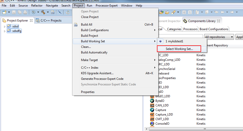

randyhermes
Thank you again Alice,
Unfortunately "Select Working Set" is not active under Project/Build Working Set.
So I can't create a new one.
I've decided to just create a new workspace with the four projects in it.  Since there doesn't seem to be a simple way to create a working set definition.

Hello Randy,
If your project have been set a working set , the Project/Build Working Set is gray (not active),
you can create some new project then try this function.
And when you export it , can you screenshot it then show it to me ? I want to know why and how is wrong on your side , thank !
Alice

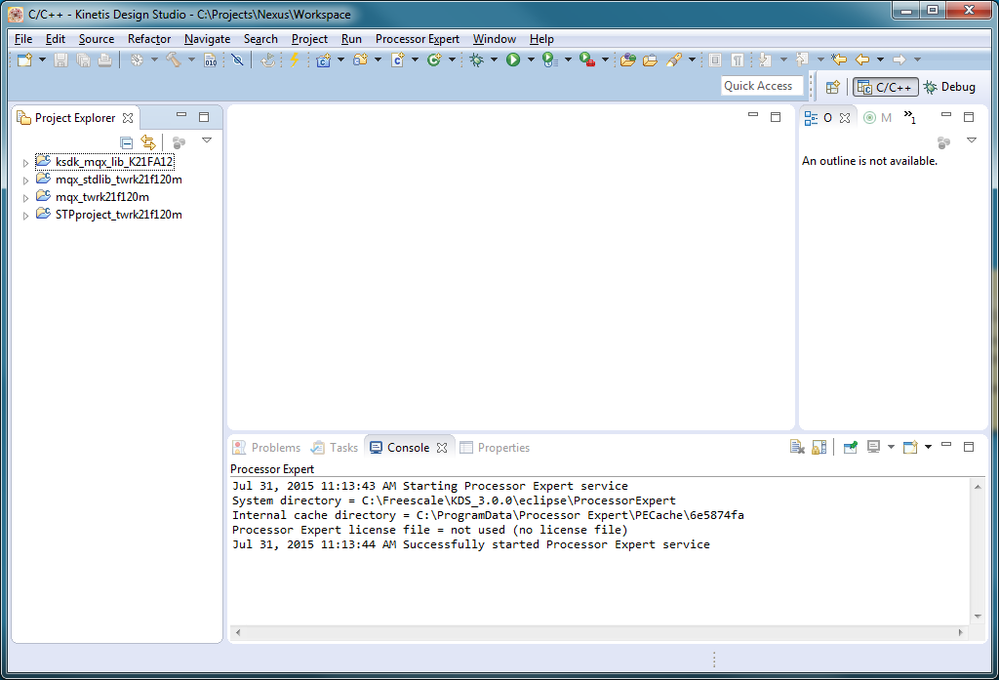

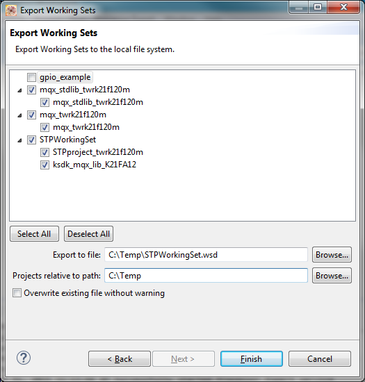

randyhermes
My Workspace
File/Export Project of Projects
Next
Note that gpio_example shows up even though I deleted it from the project explorer. I don’t think it should show up.
mqx_stdlib_twrk21f120m and mqx_twrk21f120m were originally imported as project-of projects.
STPWorkingSet p-of-p was caused by my original, failed attempts at creating a working set.
After I finish I can delete all of the projects in my workspace, import STPWorkingSet.wsp and I will have STPproject and the three libs.
6,072 Views
Hello
(1) Please uncheck the "Build Automatically " when create working set :
(2) From your last picture, it is doesn't matter show gpio_example ;
    From it ,
it not meaning there are same project , it meaning the "mqx_stdlib_twrk21f120m" is one working set ,it only include the project "mqx_stdlib_twrk21f120m".
And now from the last picture , we can see you put the three working set to the STPWorkingSet.wsd .
Hope it helps
Alice

Create a new Working Set (Project of Projects)
Select Window/Working Sets/Edit
Click on New.
Select C/C++
Click on Next
Type in a working set name and select the projects to include in it.
Click on finish.

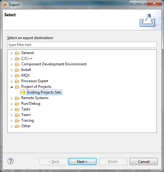

Now save to a file.
Select File/Export
In the dialog select Project of Projects/Existing Projects Sets
Now select the working set to export, Enter/Select the file name in Export to file: and set projects relative path.
Click on Finish
