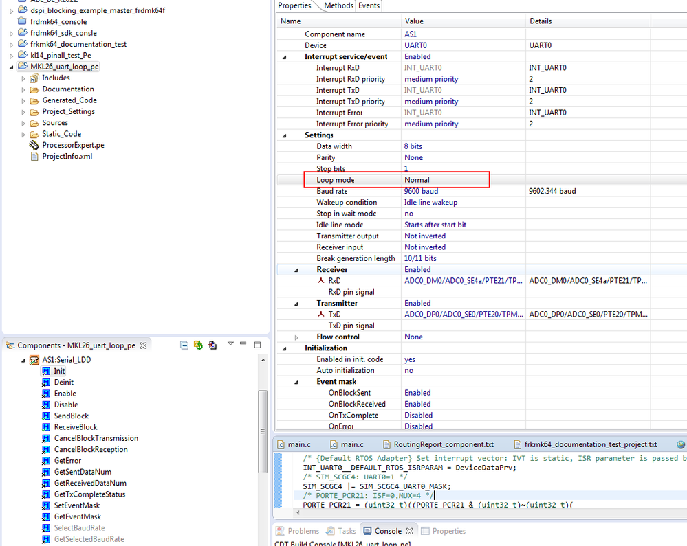

Hello Neil,
(1) In KDS, after you configure the PE with no errors , it should be no error when generate code .
So you can screenshot your PE configure view or send me your project , i will  test it on my side .

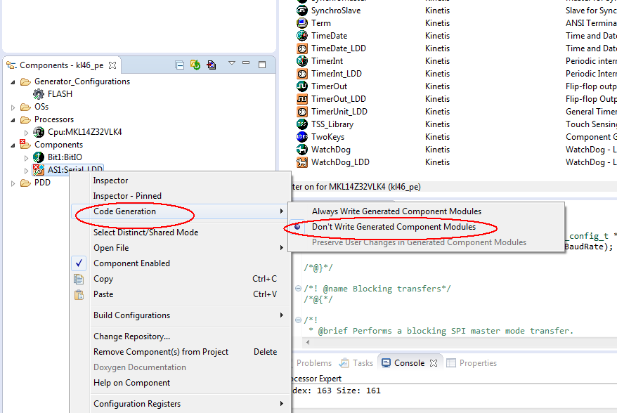

(2) If you want  the UART component do not generate code , or you want change the code , you can choose "Don't write generated component modules",
then you can change the code by hand.

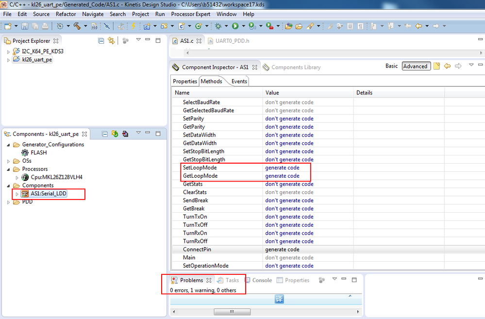

Hello Neil,
Do you mean here :
if not , could your please screenshot yours , thank !

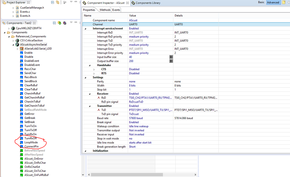

neilhancock
Hello Alice
When I set  the Serial_LDD methods Loopmode to generate code - it causes an error.
My KDS300 picture looks different than yours as below
I have it fixed so it doesn't do it - but reporting what looks like a bug, as I wouldn't expect any condition I can set in the UI to result in a failed PE Code Generation
5,089 Views
Hello Neil,
Yes , when use the component of "AsynchroSerial" , there will be error when configure the methods Loopmode to generate code ,
and i will be going to confirm
And if you use the component of "Serial_LDD" , there will be no error :
Thank for your remainder !
