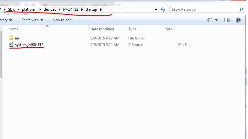

I am unable to find the system_mkk4F12 header file for the PE project created. I am trying to understand the cause for it.
Was actually trying to bulid a library in the demo example way for drivers and hal.

I just created a new KDS3.0 project but there is no problem on my side. see attached video.
1 please make user you use KDS3.0 ( New Kinetis Design Studio V3.0.0 available ) and
2. apply the Eclipse Update for Kinetis SDK into this tool using Help -> Install New Software. Then go to ..\KSDK_1.2.0\tools\eclipse_update folder to find the appropriate Eclipse update
3. please make sure you install the latest KDS3.0  update. see video i attached.
can this help you?
