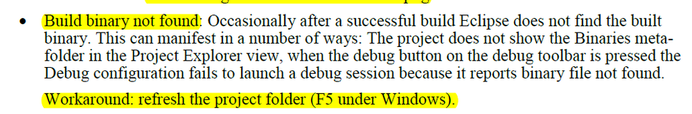

Application Launcher is giving error "Launch Failed Binary not found". how to overcome this error.
I have search in project folder there  is no .bin file is located. What might be the reason?
2,204 Views
ZhangJennie
Hi Parag,
is this problem a common issue for all project or only for a specific project.
the similar issue is recorded in release note, I extract it here for your convenience. release note is also attached.
if the problem is in specific project and happened every time, please upload your project here, I will try to work on it directly. Thanks.
