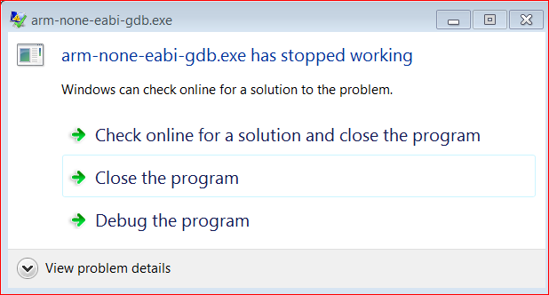

I get this error quite often with both a PE Multilink and Segger J-trace.
Trying to debug a K22.  Using latest KDS and Processor Expert.
Running bare metal.  No dynamic memory.
It started when I add additional functions to my main loop.
Any ideas?  Do I need to alter the project properties?
Tags (3)
3,844 Views
bcstewart
UPDATE:  I am using GIT (bitbucket with sourcetree).  Once I move the project outside the GIT environment, it started working.  Has anyone seen this problem before?
Some more info.
Error occurs after erasing and programming the flash memory.
Here is the terminal printout:

monitor preserve0 0
monitor selectcore 0
/home/build/work/GCC-4-8-build/src/gdb/gdb/linespec.c:2445: internal-error: decode_line_full: Assertion `state->canonical_names[i].suffix != NULL' failed.
A problem internal to GDB has been detected,
further debugging may prove unreliable.
Quit this debugging session? (y or n) [answered Y; input not from terminal]
This application has requested the Runtime to terminate it in an unusual way.
Please contact the application's support team for more information.

BlackNight
Your problem is the one described here: Failed to Debug with GDB: Breakpoints or Expressions on non-existing Locations | MCU on Eclipse
(remove all breakpoints to fix it).

bcstewart
Works, but only if you remove the breakpoint (as mentioned in the link
below).
Thanks for the help!
