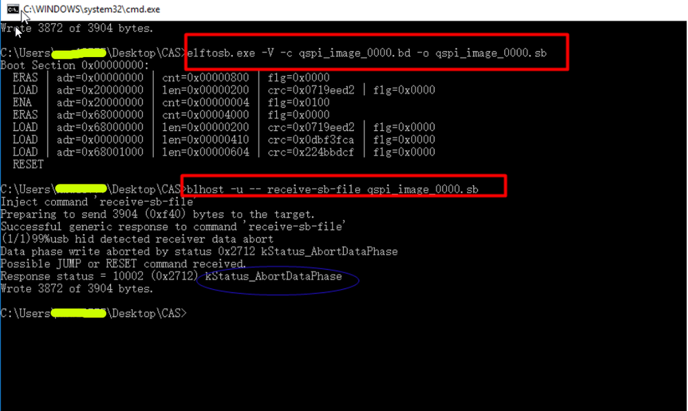

Hello John,
I use the .srec  file you shared  , it also can work well :
I put  the two .exe and  the ralted files into one folder, then generate .sb file :
I attached all the files.

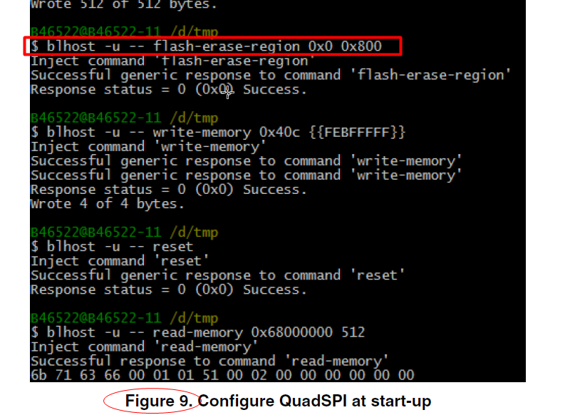

And please erase the flash to have try refer to "Kinetis Bootloader QuadSPI User's Guide.pdf"

Another data point is that I cannot write to the FOPT as the "Kinetis Bootloader QuadSPI User's Guide.pdf" suggests -- is this a security feature perhaps?  Is there another user guide that describes how to enable QuadSPI for K82?
5,117 Views
Hello John,
Please refer to "Kinetis Bootloader QuadSPI User's Guide.pdf" (path:NXP_Kinetis_Bootloader_2_0_0\doc) .
About the QCB file , you can directly use KBOOT provicde : NXP_Kinetis_Bootloader_2_0_0\apps\QCBGenerator\binaries\qspi_config_block.bin
About the .BD file , you can first use KBOOT provide :NXP_Kinetis_Bootloader_2_0_0\apps\demo_qspi\bdfile\qspi_image_0000.bd
I test with the usb port of FRDM-K82F board, it can work well .
Please refer to it have a try, if still have question , please contact us without any hesitate .
Hope it helps
TIC

I've re-run elftosb.exe -V -c qspi_image_0000.bd -o qspi_image_0000.sb against the files you mentioned to generate a new .sb file, however I'm still seeing a "kStatusMemoryRangeInvalid" error after 160 bytes on my FRDM-k82F board:
blhost -u -- receive-sb-file qspi_image_0000.sb
Inject command 'receive-sb-file'
Preparing to send 3904 (0xf40) bytes to the target.
Successful generic response to command 'receive-sb-file'
usb hid detected receiver data abort
Data phase write aborted by status 0x2712 kStatus_AbortDataPhase
Response status = 10200 (0x27d8) kStatusMemoryRangeInvalid
Wrote 160 of 3904 bytes.
Find attached, my led_demo_qspi_0000.srec file, which was from the project located at: NXP_Kinetis_Bootloader_2_0_0/apps/demo_qspi/led_demo/targets/FRDM-K82F/kds/led_demo_qspi_0000/release

Hello John,
TIC

hemlock
Ah you're right -- I need to erase the memory before it can be written -- thank you!
