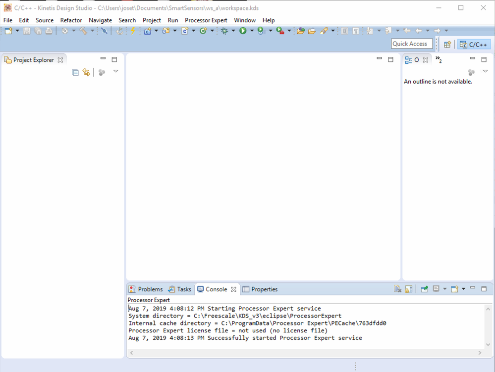

Haloo Erich!  I'm working with Jose on this project; here's a little additional info.  The short form: workspace A and workspace B seem to be nearly identical, but workspace A doesn't show any files in the file explorer while workspace B does:
Here's what we see when we open workspace A:

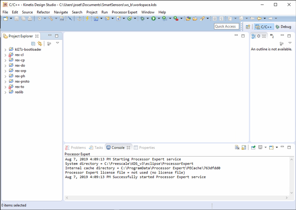

Here's what we see when we open workspace B:

Strictly speaking, there IS one other difference: workspace A (the failing one) has "windows" style line termination while workspace B (the working one) has "unix" style line termination.
But Jose and I are baffled as to why workspace A fails and workspace B works.
Is there any other info that would be helpful?

BlackNight
>>Workspace A was a git repository (in theory identical to Workspace B) that was pushed to github and then pulled back to the local machine.
Alarms are going on now. So I read this that the workspace (.metadata folder) has been  copied (by the pull) to a different location? As a general rule: never share/copy/alter the .metadata folder/location as it contains machine/envirionement/location specific information. The .metadata folder location should not be moved, otherwise 'strange' things like the one reported here will happen. Never put the .metadata e.g. on a VCS or move it around. Start with a new workspace. Think about the 'registry' on Windows: you cannot simply copy that to another machine, it will break. The .metadata folder contains caches and all other kind of things, and unless you know *exactly* what you are doing, keep it as is.
Maybe I read the details in a wrong way? In any case: do not 'share' the .metadata folder in a version control system. The only way it *might* work if you pull that folder into the exact same location on exact the same machine.
I hope this helps,
Erich
