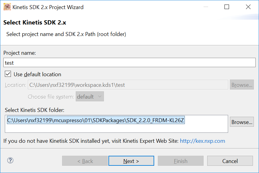

I need to maintain a project based on K27. I'd like to test on frdm K27 some things before to work on the official project but I can not see in the wizard menu the K27 freedom board just to start.
From the new project I select "kinetis sdk 1.x"  but does not appear the frdm k27.
I downloaded the sdk SDK_2.3.1_MKL27Z64xxx4 too. But I thinks it's not right installed.
Seem to be impossible to see the freedom board in the wizard.
Thanks in advance.
Claudio

Hi Claudio,
I'm a bit confused of what MCU do you use, K27 or KL27? They are different device, K27 is M4 core and KL27 is M0 core. K27 hasn't FRDM board. It share FRDM board with K28, that is FRDM-K28F. So, if your target is K27, please download K27 SDK from https://mcuxpresso.nxp.com.
Please notice that KDS is fade out. SDK version 2.4, 2.5, 2.6 is not support KDS. So you must select the version lower than 2.4.
Jing

You have to know I tried, downloading the SDK_2.3.1_MKL27Z32xxx4, to try to install the sdk.
I'm using the procedure "Help", "Install New Software".....But I can't do it.
I do mistakes about it I think.
Do you have the installation procedure, starting from downloaded zip file ?

1. Unlike MCUXpresso, KDS doesn't need to install SDK package. You should tell it where is the SDK when you are importing a example.
2. When you build SDK package in https://mcuxpresso.nxp.com/en/builder , you should select "all toolchain" or "Kinetis Design Studio"
3. You should not select "kinetis sdk 1.x". You should select new->"kinetis sdk 2.x project".
By the way, NXP suggest customer use MCUXpresso IDE now. It is better than KDS. KDS is fade out.
Jing
