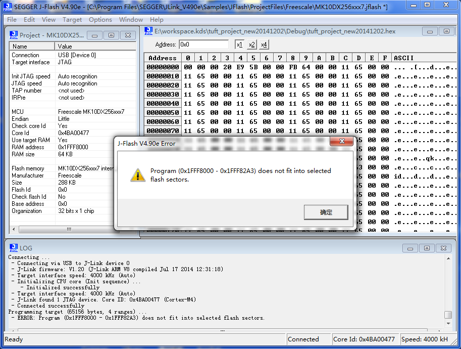

Today, I use J-Flash (J-Link tool) to program the project flash image file .hex to the chip MK10DX256VLH7. Unfortunately, J-Flash push the error message as follows:

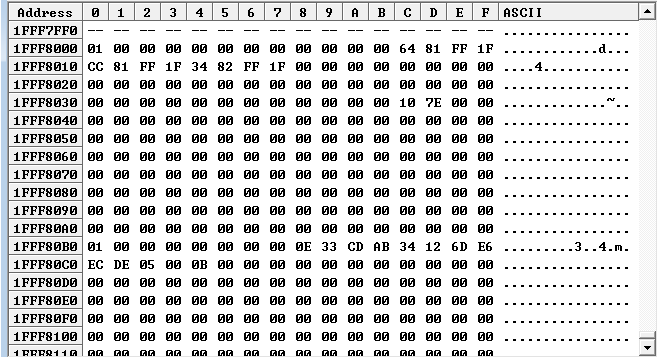

I check the .hex file, surely there existing data on the address 0x1fff8000-0x1fff82A3.
I don't know why KDS make the flash data on this range of address 0x1fff8000-0x1fff82A3.

I wonder you select build configuration as "RAM " ? please make sure you select build configuration as "Flash" instead of "RAM"
make sure your project use correct ld file(allocate code/data in proper memory ).

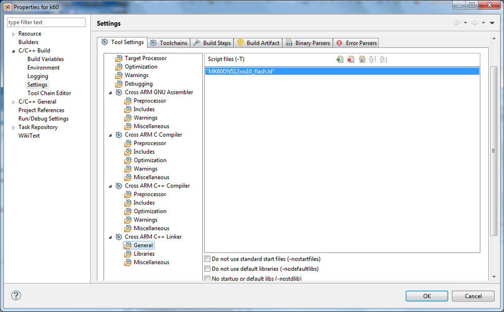

in linker setting, we can see which *.ld file is used in your current project.
then you search out this ld file under your project folder, see how the memory management inside. see if all the code is allocated in flash.
