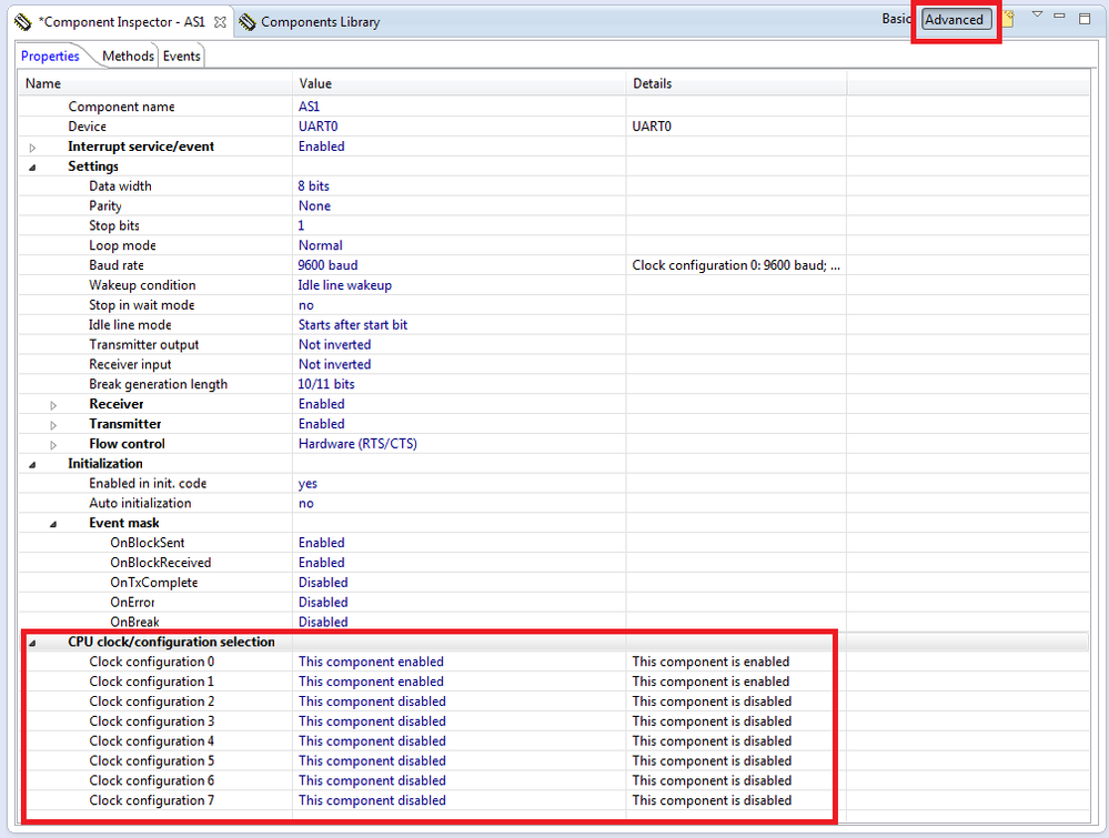

- the Serial_LDD component allows you to select one baudrate that will remain the same for all clock configurations where the component is enabled. Select the Advance view in the Component Inspector window of the Serial_LDD and open the CPU clokc/configuration selection group of properties, see the screenshot below.
I have also created a simple application with the CPU (I have put all three clock configuration into the project) and Serial_LDD, see the attached file (it runs on the FRDM-K20D50M target board).
