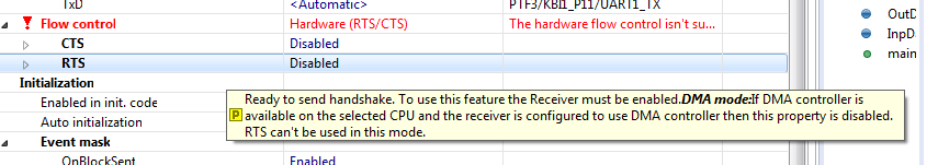

The only possible way is UART should felicitate an automatic handshake (set/reset RTS). When I checked the Processor Expert Component Properties of AsynchroSerial Component I found this. RTS Handshakedoubt.jpg
How does the above feature work ?

Hello Gnesh,
About this feature , you must enable DMA first, or you  can not use this feature :
Hope it helps

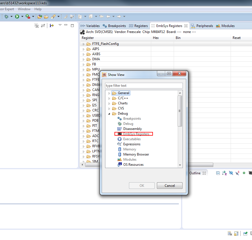

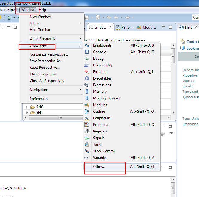

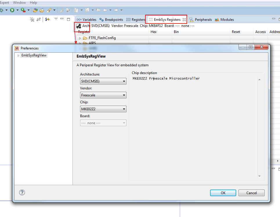

Hello Genesh,
You can check the UART data register through "EmbSys Registers":
Window ->  show view -> other ....

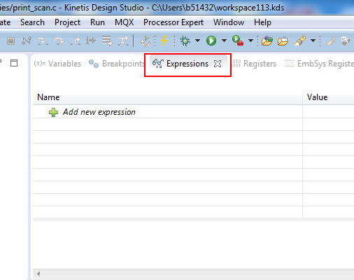

if you want check variable,  you can use the "Expressions" view:
Hope it helps
