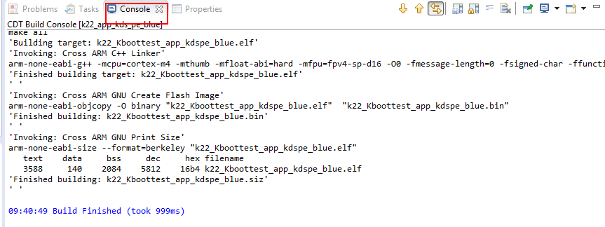

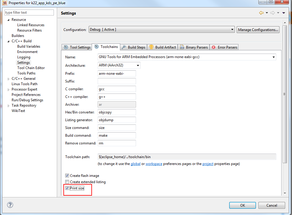

Hello Neil,
Please enable the "Print size" :
then build your project , you can see the code size on the "Console " window :
Hope it helps
Alice
2,504 Views
Hello Neil,
Hope it helps
Alice
