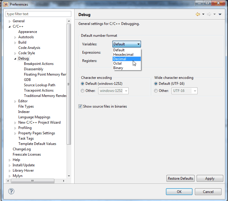

I can't believe I am asking about something that should be so trivial, but I suspect I must be missing something.
I can view variables in KDS when I am debugging but they are ALWAYS viewed as hex. Sure, I can see the data values in different formats below. What would be especially helpful is to see chars as ASCII characters.
Is this not just build-in? Do I need a plug-in to do this. BTW. I have installed Erich's plug-in to view variables but its not clear that anything is different. Perhaps his plug-in is the solution and I just need to know how to get it working?

Hi Tharon,
With CW10.6 it as more straightforward to Right Click on the variable and change the "format" to whatever you want.
With KDS you can set global default from the properties window (Debugging Variables in Hexadecimal with Eclipse | MCU on Eclipse):

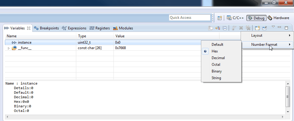

Or locally in the variable window (Variable Debugging with Eclipse Kepler | MCU on Eclipse) :

OK, I am not sure why, but it's like all of a sudden it"got smart". I followed the instructions and discovered that the down arrow is the key to changing the format. After playing with it, now value shows an ASCII string when a pointer is pointing to a char array and it even shows meaningful values, such as "StringMsg::AVAILABLE" in my case.
The funny thing was it wasn't doing that before. Odd, but glad it's working. :smileyhappy:
