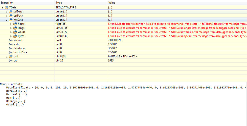

I have a structure with a few layers and it seems that the debugger has a difficult time showing the memory at specific structure members.  Is it a problem with viewing unions?  Any thoughts?
The error that runs off the screen is "Type struct{...} has no component named floats.  Unable to create variable object".
It can obviously parse it at some level since you can see all of the data in the "details" below.

Did some digging, and this seems to be a generic GDB problem. I see it in other GDB IDE's too.
typedef struct {
  union {
    int i[16];
    char c[32];
  } a;
} U;
It fails for for named unions (name 'a' above) with arrays in it. it works if I use anyonmous unions like this:

would it be possible to post that data structure typedef so I can try to reproduce it?

No problem:
#pragma options align=packed
typedef struct {
    union {
        float floats[38];
        uint32 longs[38];
        uint16 words[76];
        uint8 bytes[152];
    } calData;
    union {
        float floats[38];
        uint32 longs[38];
        uint16 words[76];
        uint8 bytes[152];
    } usrData;
    union {
        float floats[35];
        uint32 longs[35];
        uint16 words[70];
        uint8 bytes[140];
    } netData;
    float version;
    uint8 state;
    uint8 dataType;
    uint8 hasUsrData;  // both user and net data were downloaded
    uint8 pad[3];
    uint16 crc;
} TRG_DATA_TYPE;
#pragma options align=reset
And the data types are pretty standard:
typedef unsigned char           uint8;
typedef unsigned short int      uint16;
typedef unsigned long int       uint32;
5,928 Views
BlackNight
thanks for sharing. I confirm that I'm able to reproduce the problem. I see what I can find out.
typedef struct {
  union {
    int i[16];
    char c[32];
  } a;
} U;

I don't know if that workaround will help you. It would be to use anonymouse unions like this:

I have no problem with that suggestion.  Thanks for looking into it!
