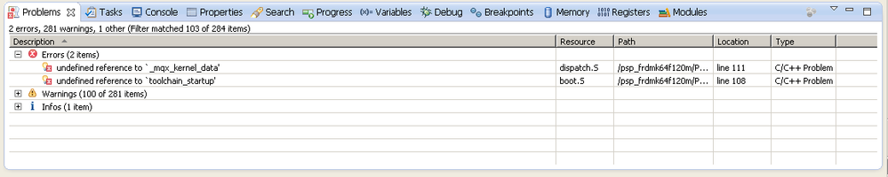

I am trying MQX with KDS1.1.1 and KSDK1.0.0
I have followed all the steps described in "Getting Started with Freescale MQX RTOS for Kinetis SDK.pdf"
build_libs.wsd was imported and BSP, PSP, MQX_stdlib and KSDK_mqx_lib libraries were compiled without any problem, in debug mode.
But when I compile the "Hello" example, i've got the following linker errors :
Have I missed something ?
I just followed the steps in the doc...
Otherwise, I can generate code with Processor Expert and MQX using KDS New project feature.
Any comment will be highly appreciated :-)

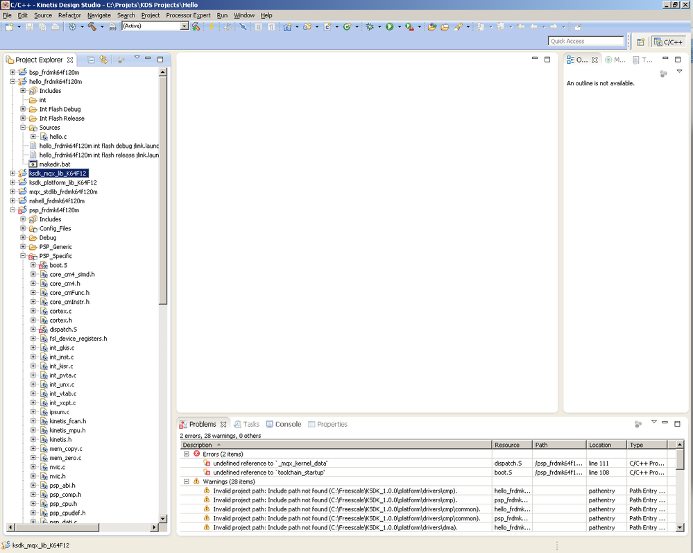

mauricelauze
Hello Alice,
Please find here a screenshot of my KDS. The five projects are included and I added the ksdk_platform_lib_K64F12.
There are still some linker errors.... It seems that something is wrong in the project settings as some code is not generated as it should be...
Anyway, I just opened the workspace, followed the steps of the "getting_start" process as I mentioned before.
Previously, I was using KDS1.0.0 Beta and I uninstalled it before installing KDS1.1.1
Thanks for your reply,
1,979 Views
mauricelauze
Please take a look at the "problems" screen.
There are a lot of warnings...
The last one is rather strange... C:\Freescale\KSDK_1.0.0\rtos\mqx\config\frdmk64f120m
doesn't exist.
Instead, I have C:\Freescale\KSDK_1.0.0\rtos\mqx\config\board\frdmk64f120m
In the \config directory, I have \board, \common and \mcu

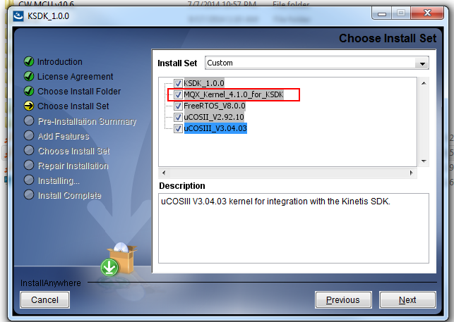

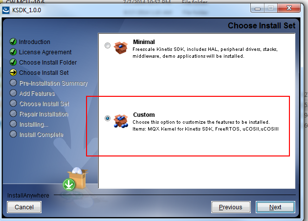

Can you build  SDK sample without  MQX  successfully?
And  when you installed the SDK, have you select the" MQX_Kernel_4.1.0_for_KSDK " ?
