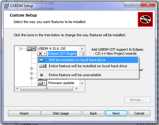

Just install USBDM as usual but select the Eclipse CDT Plugins  installation:

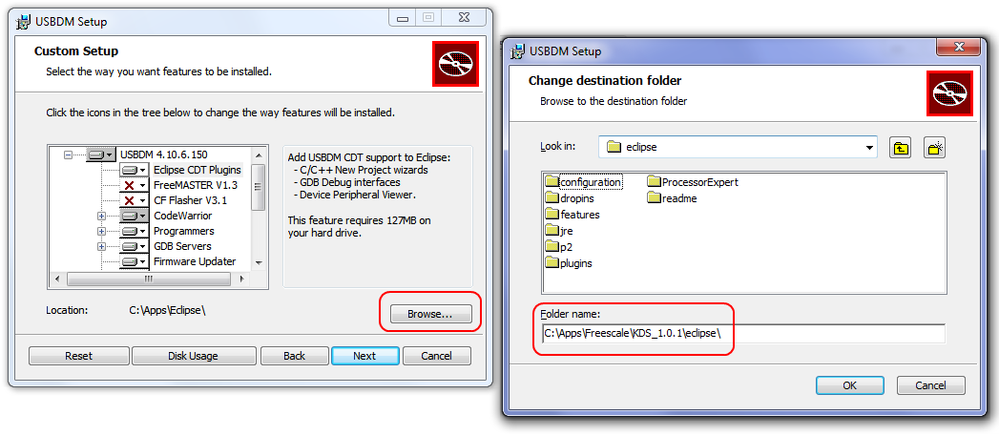

Then browse to the eclipse subdirectory within the KDS installation directory:
Complete the installation.

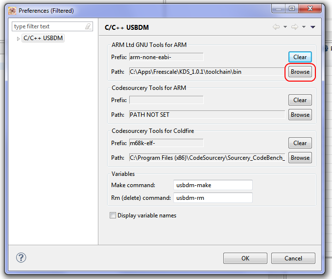

After installing you will need to configure USBDM in Kinetis Design Studio (Eclipse):

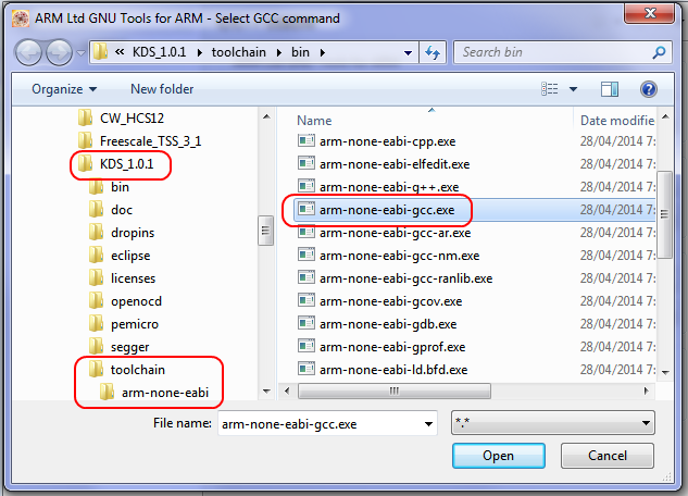

Select the Browse button to locate the ARM tools that USBDM needs.  This can be pointed at the ARM-GCC installation included in KDS.

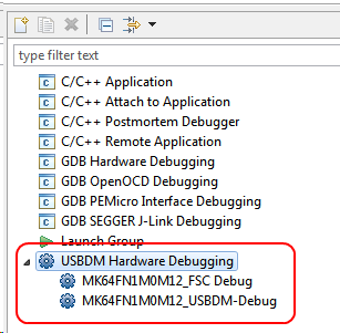

You can use your usual KDS projects but now can create a USBDM launch configuration.
For more details on this see Launch Configuration Settings this link:
USBDM: Eclipse - New Project Wizard

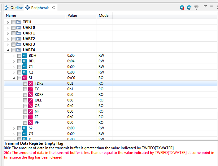

An added bonus is that you also gain a Kinetis peripheral register viewer:

When installing USBDM please select the eclipse directory in the KDS installation - not the KDS root as shown in the screen grab above.
Sorry for the misinformation.
To fix without re-installing copy the contents of the dropins directory that was created in the KDS root directory into the eclipse\dropins directory.
Alternatively uninstall and re-install with a selection of the KDS/eclipse directory.
I will update the above screen grab shortly.

geoffs
Brilliant !  As you suggested, I moved the "USBDM" subdirectory from the KDS_1.0.1\dropins directory into KDS_1.0.1\eclipse\dropins instead, and now it works fine.
