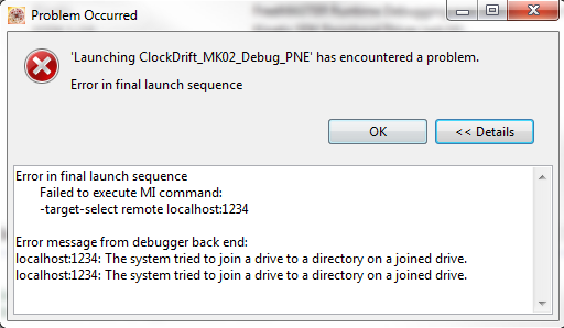

I am unable to communicate with the USB MultiLink.

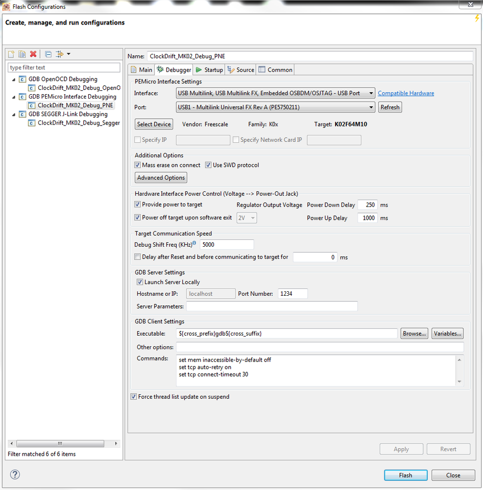

I choose FLASH FROM FILE.
Then the GDB PEMICRO INTERFACE DEBUGGING configuration. ( I am not using OpenOCD ore the SEGGER)
Then after a timeout I get the following error:
I have never dealt with using a GDB or this "LocalHost" environment since CodeWarrior 10.3 was not using a local server.
In all honesty, I would be happy with the ability to simply FLASH the .ELF file to the microcontroller without having to deal with debugging or servers. Is there a way I can simply send the file to the microcontroller without all this hassle?

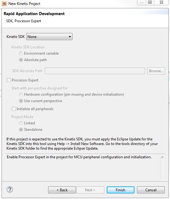

I set up a dummy project to program my existing MKL05 Kinetis microcontroller. Everything worked fine. Flashing the part was successful. One thing to note however: When setting up the project, the MKL05 is unable to use the KSDK 1.2.0, so I disabled it all together and only had Processor Expert selected.
As for the MK02 (The one I'm trying to get working), when I set up the project, I am not able to deselect the KSDK option and still be able to use Processor Expert. See the image below.
Am I the only one having the problem because it's not like I went in and changed a whole bunch of custom configurations. I simply installed the software, installed the updates, and tried to build a project and program the microcontroller...

Please take a look to Erich's recommendations on these posts and let me know if they help with your connection problems,:
GDB Client and Server: Unlocking GDB | MCU on Eclipse
Debugging Failure: Check List and Hints | MCU on Eclipse
If the problem persist then it is possible that it is a hardware problem, in that case, could you share your schematics so I can review them?
Regarding the new project wizard not allowing you to select only Processor Expert for the MK02 device, this is because the K02 device is not directly supported by KDS,  the support for the MK02 device is only through KSDK.
You can review the devices supported by KDS here:
http://cache.freescale.com/files/soft_dev_tools/doc/support_info/KDS300RN.pdf
And the additional supported devices after installing the KSDK 1.2 update here:
http://cache.freescale.com/files/soft_dev_tools/doc/support_info/KSDK120RN.pdf
