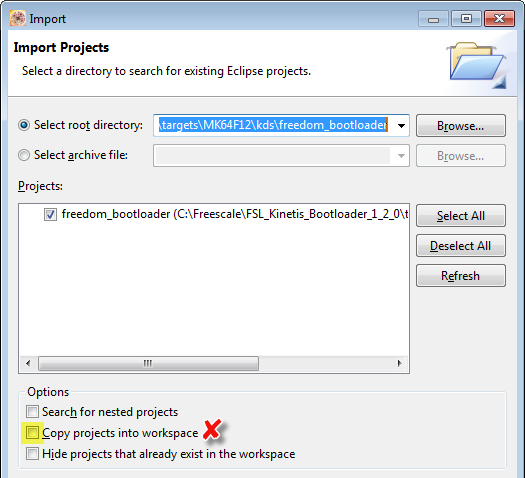

I am using KDS 3.0.0 and KSDK 1.2.0 to build FREEDOM K64F Bootloader and found the problem, see attached doc.

Carlos_Mendoza
Hi Cristie,
Those errors happen because the project was imported to the workspace with the "Copy projects into workspace" enabled, when you only import the example project to your workspace, then you are leaving the project in its original location in the file system and the links are still valid, but when you "copy" the project to the workspace, only the project folder is copied and not the linked files/resources causing those errors when compiling.
In order to fix the problems you need to delete that project from your workspace and import the example again but this time make sure the "Copy projects into workspace" is not selected:
Hope it helps!
Carlos Mendoza
Technical Support Engineer

Jorge_Gonzalez
Hello Christie:
Remove the project from the workspace and import it again but DO NOT select "Copy projects into workspace":
The source and header files are "linked" to the project. If you copy the project then the links are broken.
Regards!
