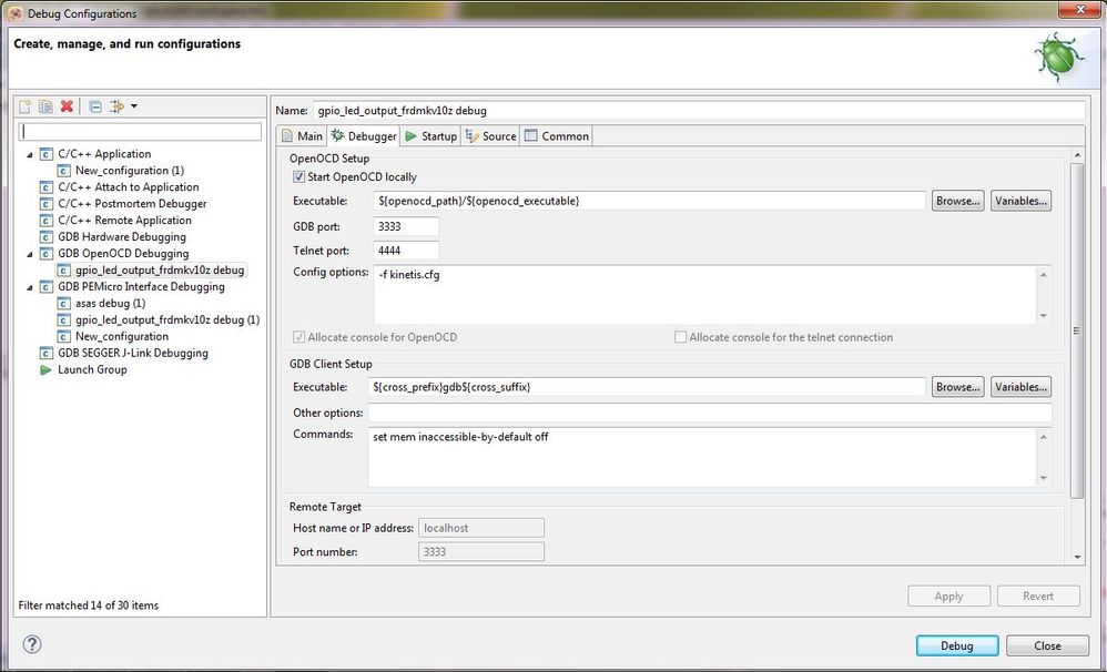

Could you kindly let me know which configuration of the three – OpenOCD, PEMicro and Segger should be used. I have tried the C/C++ MCU application and the GDB PEMicro interface debugging.
I had first installed MCUXpresso and I was able to debug the LED blinking code on it. Then I installed KDS 3.0.0.0 but could not debug the LED blinking code on it. I uninstalled both the software’s and all the related drivers and re-installed only KDS but still the same problem persists. I also disabled the anti-virus software and tried again but I received the same error message.

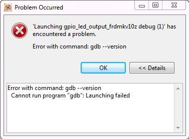

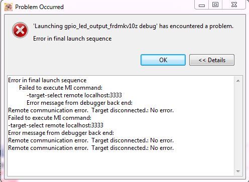

The error message related to
C/C++ (NXP Semiconductors) MCU Application is as follows
GDB PEMicro is as follows
The debug configuration is as follows

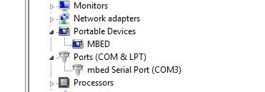

And the device manager window is as follows

Hello ,
-  "Could you kindly let me know which configuration of the three – OpenOCD, PEMicro and Segger should be used."
   -> This is refer to the firmware in your board, please check it in the device manager. For example your screenshot
pastedImage_1.png , it should use the OpenOCD debug .
 If it shows pastedImage_2.png in device manager, it should
use PEMicro : pastedImage_3.png.
If pastedImage_4.png, this is pastedImage_5.png.

Please find the KDS debug configuration screenshot. I have uninstalled MCUXpresso IDE and will be suing KDS.
I am still unable to debug in the openOCD debug as well.

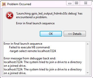

I am getting the following error message:
Kindly let me know how to proceed further.

Please try to use the  SEGGER J- link debug mode to have a try.
Update the firmware of your board use my attachment .
About how to update firmware,and  debug for FRDM board, you can refer to this doc:
Summary of FRDM-K22F debug interface
Hope it helps
TIC

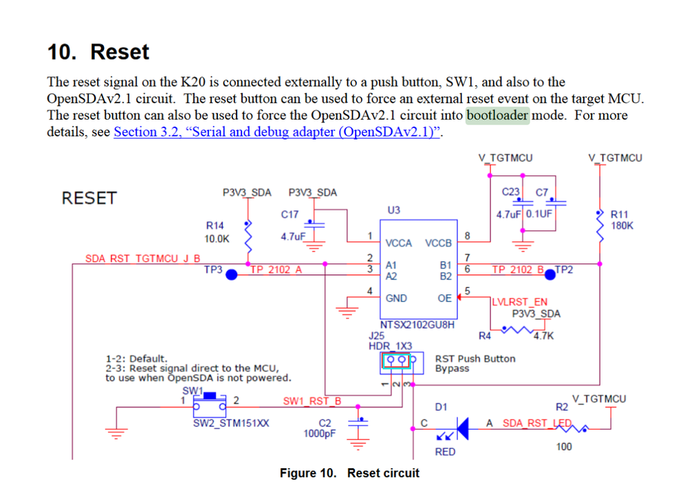

Hello ,
I haven't this board, so I can't test on my side. Please take a video about how to do on your side,
and also about the Device Manager . Please be sure the jumper J25(1-2) on your board:
Alice
7,935 Views
mutullaheser
Dear Alice,
Thanks fro your reply!
The jumper was placed on the incorrect pins. After placing it in the correct position, I got an error of 'The connected emulator deos not support serail wire output (SWO)' but I found a solution for it.

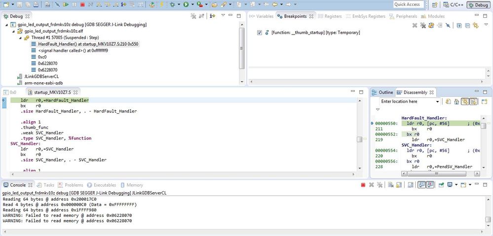

Now, in the J-link debug mode, I am able to enter the debug mode but the 'debug start' button is inactive and I get a message that 'No source available for "0x0" '
7,935 Views
mutullaheser
Dear Alice,
I tried to work on the problem by the points suggested in Debugger disconnects after code download
but the problem persists. I tried the following point:
  • Removed all the breakpoint
  • In the debug configuration, startup tab changed ‘set breakpoint at’ from ‘main’ to __thunm_startup
  • I also tried to do an assembly step but the code enters Hardfault_handler and gets stuck over there.
  • I also did a clean and build but no effect
  • Restart PC
    Could you let me know what can be done to solve the problem?

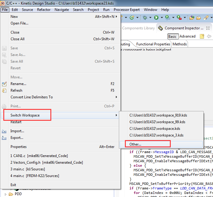

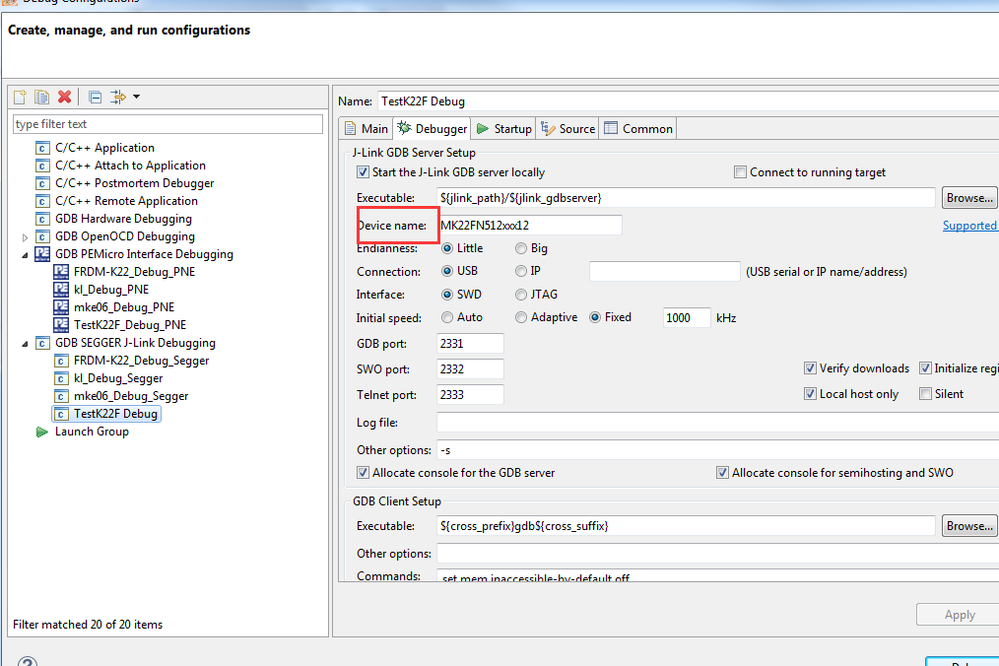

Hello ,
Please change to a new workspace , create a simple  new project to have a try:
Please pay attention, input the correct device name :
7,935 Views
mutullaheser
I switched the workspace but still facing the same problem.
I entered the device name: MKV10Z32VLF7   for the FRDM-KV10Z development board.
