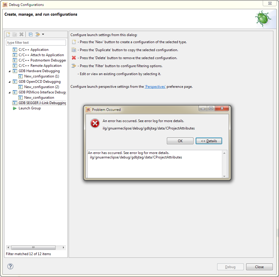

After a fresh install of KDS, everything works. Once I do a software update I can no longer debug.
I have tried starting a new work space and that doesn't help.
When I select Debug Configuration I get the following error:"An error has occurred. See error log for more details. ilg/gnuarmeclipse/debug/gdbjtag/data/CProjectAttributes"
I would attache the log file, but I have no clue where the folder ilg is.
This is my versions after the update:

I found this log snip-it in my workspace folder, it looks like it might help
!ENTRY org.eclipse.jface 4 2 2015-08-03 11:14:48.447
!MESSAGE Problems occurred when invoking code from plug-in: "org.eclipse.jface".
!STACK 0
java.lang.NoClassDefFoundError: ilg/gnuarmeclipse/debug/gdbjtag/data/CProjectAttributes

18,071 Views
BlackNight
Good news: the KDS team has found a patch to re-enable J-Link debugging after that GNU ARM Eclipse update:
  1. Close KDS/Eclipse
  2. Download the attached 'plugins.zip'
  3. Extract the two plugins in that zip file to the 'plugins' subfolder of your installation folder (C:\freescale\kds_v3.0.0\eclipse\plugins)
  4. Confirm to replace the original files
  5. Restart KDS/Eclipse. Segger J-Link debugging is possible again.
We are looking into the root cause of the problem. But until there is a better fix, I recommend the above workaround.

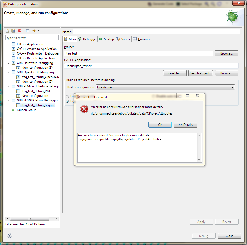

PetrK
I'm also facing to same or similar issue. After update I'm not able to create "GDB SEGGER J-link Debugging" configuration. All other (Hardware, OpenOCD, PEMicro) are OK.
Version of j-link software is 5.0.1e.
Petr

PetrK
Hello Iva,
When I updated KDS, the debugging was impossible, because almost all setting were missing. So, I deleted debugging configuration and tried to create new one and then the error occurred.
I tried to delete .metadata directory and so effectively delete workspace settings and create new one, unfortunately without success.
I'll try to create new project and check if it works.

PetrK
I tried to create new project for frdm-k64f board and same happened when I tried to open the configuration:
Log message:
!ENTRY org.eclipse.jface 4 2 2015-08-05 10:52:37.796
!STACK 0

Hello
I tried it on another computer from the beginning and it works without problems. Actually I use for FRDM-KL03Z OpenSDA.
Please,when the error message comes? /can you show us error message? or it is impossible to debug without any message? Did you try it in other terminal? (putty, tera term, terminate...)
Just few points to check:
  • Do you have correctly set Debugger?
  • Did you try to load the newest firmware for the interface?
  • Have you tried Jennie Zhang´s mentioned steps?
Thank you.
Iva

peterruesch
my project was also rendered useless after performing an update :smileysad:
very annoying.
trying to reinstall KDS without doing the "check for updates" step from within eclipse...

radomirkozub-re
Having same issue,
win7 ultimate, 64-bit, new project for K66@180MHz,
segger setting not accessible, can't press "apply" button to store dialog,
everything (KDS, KSDK tol chain, segger drivers, all updates done ) reinstalled several times, no success - this product installed
and this log get after trying to configure gdb segger J-link Debugging
any help?
Radomir

ilg
In Installation History delete the update that refers to 201508011813. If this does not help, reinstall KDS from scratch and, until KDS is fixed, be sure you do not apply the update again.

peterruesch
i have reinstalled KDS and was able to debug again... luckily!
5,379 Views
jeffreyerickson
I am having the same problem. To get to the log file, in KDS go to Help->About Kinetis Design Studio->Installation Details->Configuration->View Error Log.
It seems the problem is a NoClassDefFoundError at ilg.gnuarmeclipse.debug.gdbjtag.jlink.ui.TabDebugger.setDefaults(TabDebugger.java:1969)
The package name seems to suggest this may only impact jlink debuggers. That package install date on my machine and on your info above is dated August 1. So, it's a new package released over the weekend that caused us to bump into this difficulty now.

jeffreyerickson
I use a Segger J-Link debugger on Windows 7 64-bit.
I followed your procedure and I still can't debug.  My log is nearly identical to the one posted by the OP.
