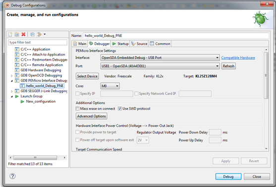

Then configure the debugger as this :

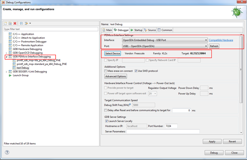

My debugging window looks as below:

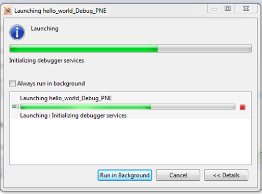

While debugging, KDS hangs at 61% as shown in following window:

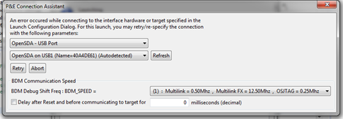

After this, P&E connection assistant window appears as shown below:

1 more thing, I got a window after P&E connection assistant. It is as shown:

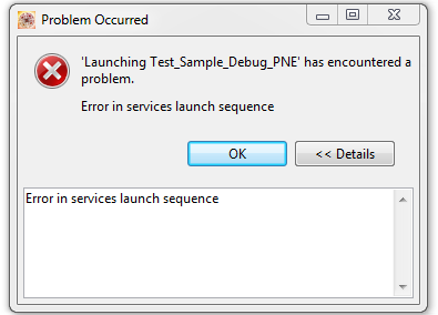

After i cancel the P&E connection assistant window, error in services launch sequence appears.

The same result. It shows first error with pop up window of "P&E connecion assistant" (as shown in above reply). Then the other pop up window shows "Error in services launch sequence".

It so strange ! From the debug configuration view , we can see the KDS has detect  the OpenSDA,
it should be connected well .At the Core option, does here have M0+? If have , please select M0+.

There is no M0+ in core option.

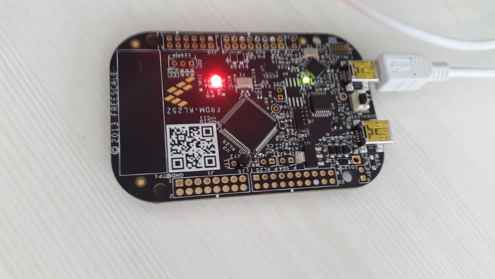

Here, below is the image for connection of frdm kl25z:
