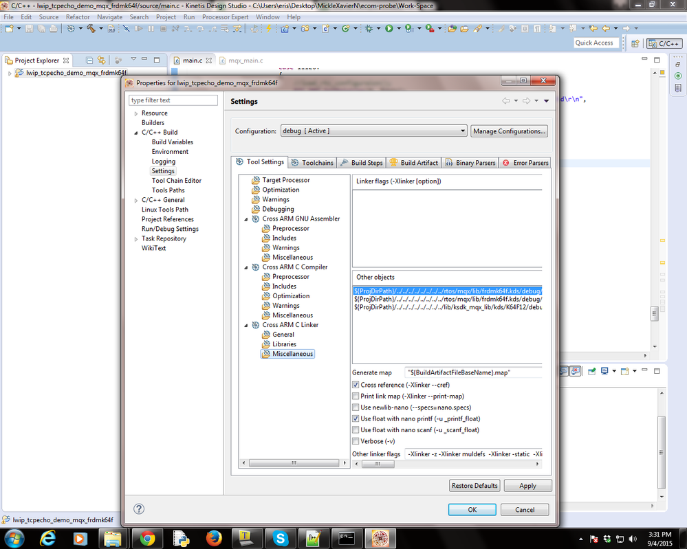

micklexavier
Hi Erich,
Thanks for your reply.
I have enabled the option -u_printf_float with the following:
Cross ARM C Linker->Miscellaneous->Use float with nano printf
But, no change in the behavior of printf.
I have added the image for your reference.
Mickle Xavier N.

BlackNight
Hi Mickle Xavier,
I have attached you a project for KDS v3.0.0 which prints float/double on the FRDM-K64F board (with Segger J-Link firmware and semihosting). The output is like this
SEGGER J-Link GDB Server V5.02 - Terminal output channel
Hello world!013456
double: 0.649217
float: 12.345600
Hello world!013456
The project is on GitHub too (just in case):
mcuoneclipse/Examples/KDS/FRDM-K64F120M/Semihosting_K64F at master ·  GitHub
I hope this helps,
Erich
