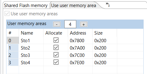

I've set up four user memory areas in upper memory:
My intent is to store operational data in these areas for safe-keeping upon power-down.

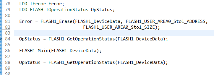

I thought I would start with erasing one block of this memory. Following the example in the "Help on this component" I have the following:

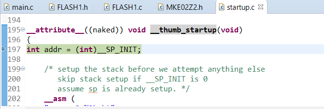

You can see the breakpoints above. I reach the first one just fine. But when I continue from there, I end up here:
 . . . as if I stumbled on a Reset or something.

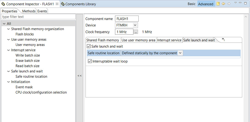

I have tried "Safe launch and wait" - with and without "Interruptable wait loop" checked. And I have tried without "Safe launch and wait".
Flash protection is set to "No protection"
There ARE timer interrupts running while I'm attempting this. Adding __DI(); before calling the FLASH_LDD methods did not seem to help.

Here is the screen shot:
