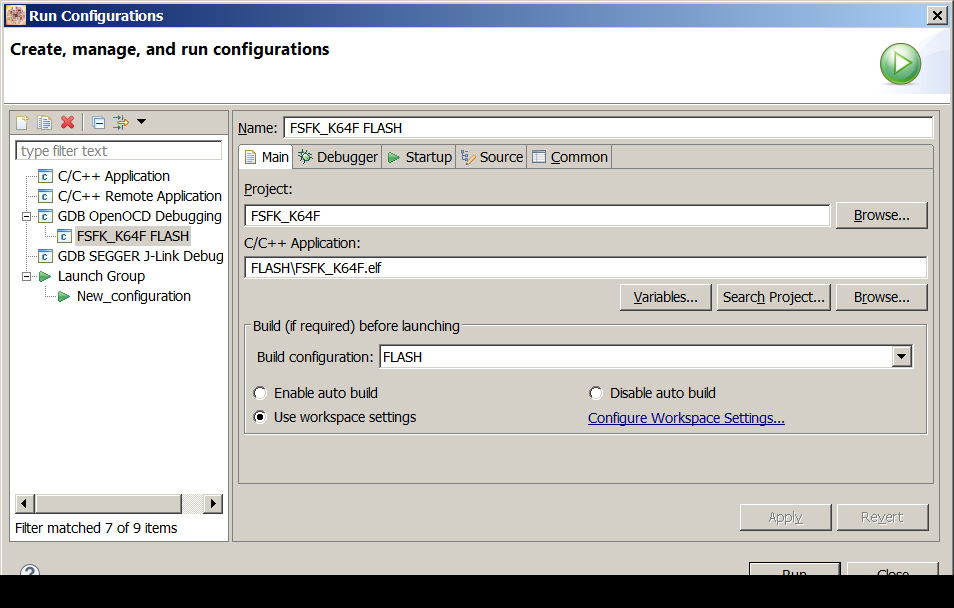

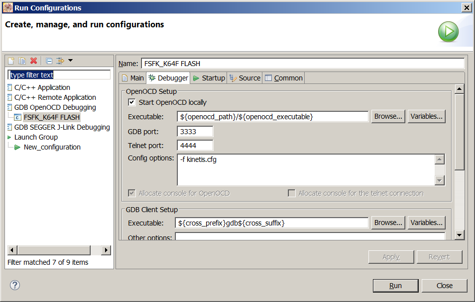

When I look at run configurations within KDS, I get:

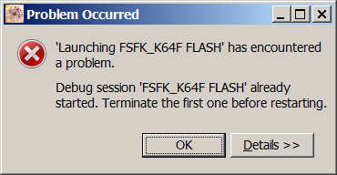

When I hit "Run", I get
Followed by:
If I try again, I get:
And then I have to close KDS and restart to try again (to no avail).

Hi Mike,
yes, KDS supports OpenOCD with CMSIS-DAP debugging. But it is less easy to use compared to OpenSDA with P&E or Segger J-Link. Unless you have a special reason to use CMSIS-DAP, I recommend P&E or Segger firmware.
One usual roadblock with mbed/OpenOCD/CMSIS-DAP is that you need the mbed serial drivers installed.
Windows serial configuration - Handbook | mbed
Next thing is that you need to make sure that the latest CMSIS-DAP mbed firmware is loaded, see Firmware FRDM K64F - Handbook | mbed
The other thing is that you might need to power cycle the board so the board firmware can properly initialize it.
Last but not least: in case you have a zombie debug process running, kill it: GDB Client and Server: Unlocking GDB | MCU on Eclipse
