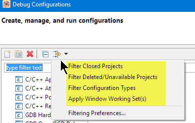

Good morning
I have a strange problem with the KDS 3.2.0
I produced a project. It  builds correctly but it is not possible to debug, since it does not appear in the list in the Debug configurations. It is visible in the attached files.
If there is a good advice it could be easy to fix
Thank You

BlackNight
Are .launch files present in your project?

BlackNight
check your filters (see my answer above).
And check if the Encoder projects have .launch files in it.

BlackNight
Hi Pietro,
that dialig lists all the .launch files inside your projects, if they reference a project, plus the ones stored in the 'framework' (if not shared as file, see Sharing Debug Configuration with Eclipse | MCU on Eclipse ). Then they are filtered too. So could it be that you have it filtered, so can you check your filters?
I hope this helps,
Erich
