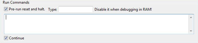

Hi Antonio,
the debugger connection page has several settings you can use, for example the one below:
You can use GDB commands to read/write memory, see as well
https://www.segger.com/admin/uploads/productDocs/UM08005_JLinkGDBServer.pdf
Erich
