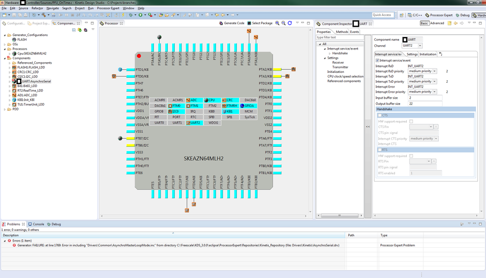

I recently upgrade Kinetis Design Studio to version 3.0.  I notice that after that, and even after running Kinetis Upgrade Assistant, I am getting the following error when attempting to generate code from Processor Expert.
"Generator FAILURE at line 1769:  Error in including "Drivers\Common\AsynchroMasterLoopMode.inc" from directory C:\Freescale\KDS_3.0.0\eclipse\ProcessorExpert\Repositories\Kinetis_Repository (File:  Drivers\Kinetis\AsychroSerial.drv)
What is the cause of the error, and how do I repair or work around the issue?

Sorry that with AsynchroSerial component in SKEAZN64MLH2 on KDS 3.0. I cannot reproduce this error. I tired to configure AsynchroSerial component with the same settings with you. Please see the screenshot.
I attached the project, does the same error appear when generating code by PE?  If not, could you please attach your project? Thanks!

stevencornett
When I removed the LoopMode code and regenerated with PE, the error code disappeared.  However, the receiver does not transfer data from the PC even though it is responding to receive requests (particularly TXBufferFull events).
The transmitter is only able to send one byte, and then stays in an error mode.  Apparently, the ASerialLDD library functions are not working.
This situation is not reversible, as attempting to bring back LoopMode causes the error to return.  This, in turn, prevents PE updated code from being generated, so whatever got screwed up in the environment stays irretrievably so.
