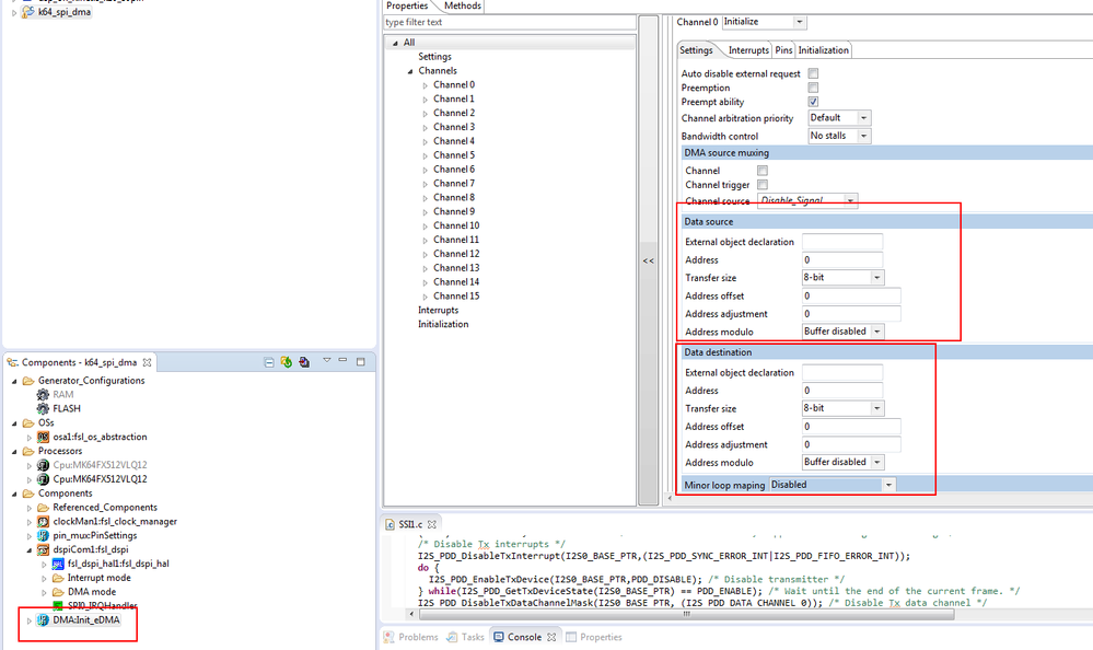

I met a problem  when i use DMA and SPI components
I add a  fsl_dspi component which came up with a  referenced component called fsl_dma.
But I can not find configurations such as source address , destination address in the component of fsl_dma .
However in the component  Init_eDMA , I can find these configurations.
When i add Init_eDMA ,it occurred an error as follow lists.
How should I add components and use when i want use spi and dma .

(1) You can do like this :Delete the "fsl_edma" from your project , then configure the "Init_eDMA" .
(2) If it still can not meet your requirements, please provide these information : KDS and SDK version , and the chip name .

if  I remove the fsl_dma, it occurred an error in the shared components of fsl_spi.
KDS is 2.0,SDK version is 1.2,the chip is mk64Fx512VLL12 .
Another problem is I just can not find the fsl_crc.

Hello heng,
Sorry to reply you so late late .....
Have you problem been solved ?
If not , please create a new project ,then add the component "Init_eDMA" . I have test on my side , it can work well , my KDS is 3.0 , i think is the same with 2.0 .
If it still have error ,please send your project to me .
And i kindly recommend you use the latest version KDS 3.0, you can download here :
