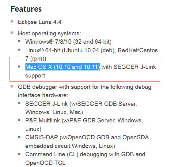

I have a FRDM-KL25Z board, and I'm using KDS V3.2 and KSDK 1.3 on a Macbook. What software, besides KDS, do I need in order to program my board on macOS Sierra. I've seen another SW, Segger J-Link, but I don't understand why I need that if my board uses OpenSDA, and if I need it, which one? There are many J-Link softwares. I'm really confused with the SW required.

Hello Carlos,
-From the KDS features introduce , KDS support  Mac OS X 10.10 and 10.11.
- Please first try to the OpenSDA (do not use external debugger Segger J-link),
refer to  the below steps update the on board debug interface to Jlink :

- Then refer to KDS user guide -> Debugging projects to debug your project, please use a simple
project firstly.

Thank you so much for the info. Just have a doubt, my computer has Mac OS 10.12.6, would it work on this?
