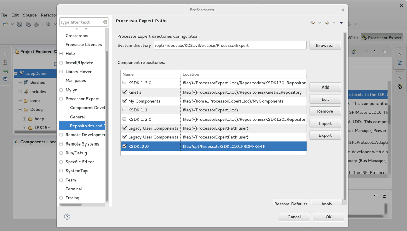

Now, I would like to use the FRDM-K64F-AGM01 (both, K64F + STBC-AGM01) with Processor Expert and ISF 2.2 (Intelligent Sensig Framework).
I have installed KDS 3.0.2 (eclipse platform 4.4.2)
Processor Expert for KDS version -> 3.0.2b151214
Processor Expert KPSDK specific features -> 1.3.0.RT7_b1550-0615
Processor Expert Core -> 1.4.1.RT7_b1550-0615
Freescale Custom Actions Updater for Eclipse 3.7 and 4.2.x ( version 2.0.12)
Installed the Processor Expert PEupd file containing the ISF components  ISF R2P2 PEx.PEupd
Generated the SDK 2.0 to FRDM-K64F and added to Processor Expert Paths. (image 1)
(image1)
I tried to create a new Processor Expert project but does not allow me to select the Kinetis SDK 2.0 in Rapid Application Development.  Only KSDK_1.3.0, KSDK manual selection or None.
Is it not possible to create a PE project with the SDK-2.0 or no other way for it?

Hi Javier,
Processor Expert does not support KSDK2.0.
Erich Styger found workaround and made this working and he describe his solution on his blog, see for example: https://mcuoneclipse.com/2016/05/15/mother-of-components-processor-expert-with-nxp-kinetis-sdk-v2-0-...
KDS 3.2 contains New Project Wizard for SDK2.0 (creates projects without Processor Expert).
