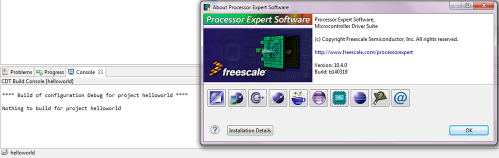

sbm_afc
I am also having similar problems related to Processor Expert
None of the projects that I try to build will build successfully, they all say "Nothing to Build"
What is the right way to troubleshoot this problem?
--AC
8,804件の閲覧回数
BlackNight
your screenshot indicates that this is *not* Kinetis Design Studio you are using? This is a screenshot of the Processor Expert Driver Suite v10.4, and not KDS. And then it makes sense that you do have nothing to build: The Driver Suite does not come with a tool chain, but interacts with tools like IAR or Keil (or your choice of GNU tools). So if you want to build inside the tool, then I suggest that you use KDS?
Below is what you should see from KDS V1.1.0 about box:
Erich
