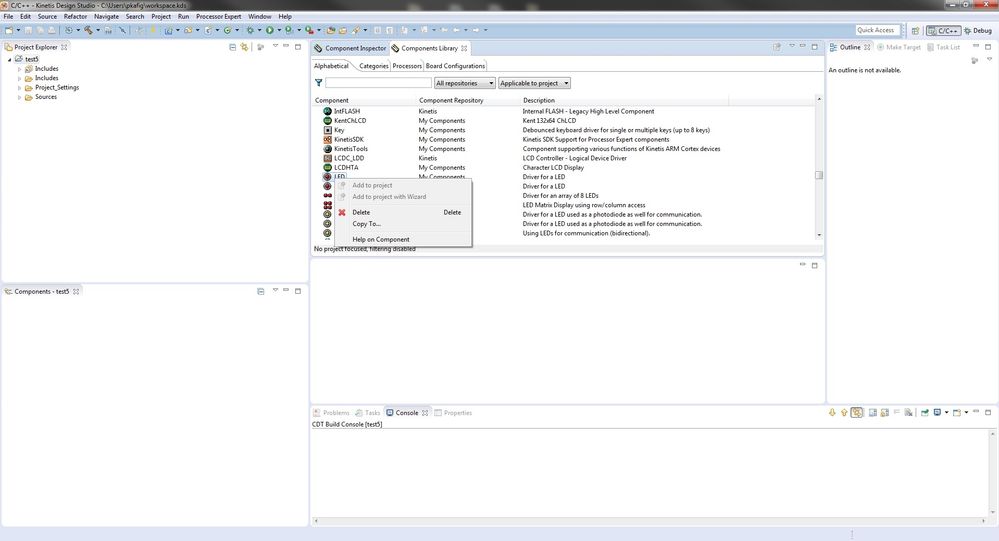

paulkafig
Sorry for the delayed responses. In addition to trying to get this board up and running, I'm putting out other fires. I'm sure you know the drill. Anyway...
Here's my process:
* File --> New --> Processor Expert Project
* I enter the name (e.g. test5)
* When I'm asked to select a board/processor, I can't find the one I want (MKL43Z, which is the demo board I'm using), but I just select one at random anyway to create the project.
* Processor Expert --> Show Views
I get the following:
As you can see, the ability to add components is grayed out.
3,912 Views

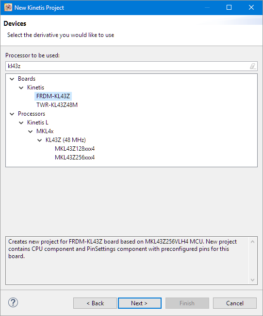

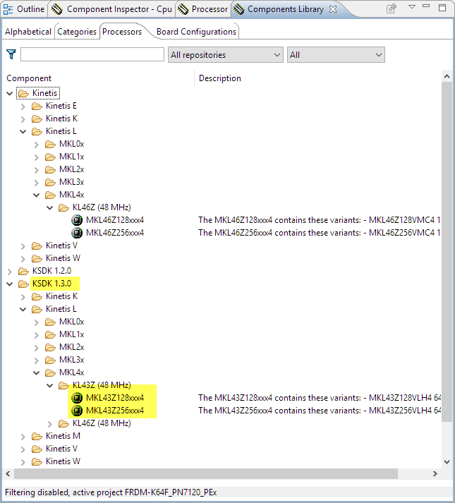

From the structure and files in your project, I think you don't have a Processor Expert project created for the KL43Z.
That explains why you cannot add components.
KL43Z is supported in Processor Expert only with the Kinetis SDK V1.3:
So you need the Kinetis SDK V1.3 for the KL43Z installed. Then you can do File > New > Processor Expert Project for it:

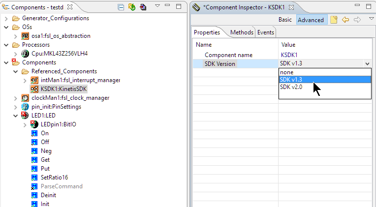

Some of the McuOnEclipse components can work with different SDKs, but then the steps are naturally different. If you want to use the LED component, then configure the SDK to be the V1.3 (what you are using):

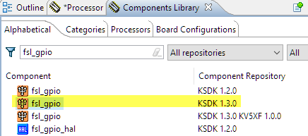

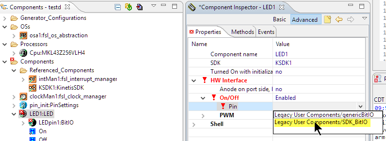

You have to use a SDK_BitIO component like this:
Add the fsl_gpio for the SDK 1.3.0:
LED1 is on PTD5, so specify this in the LED component:
