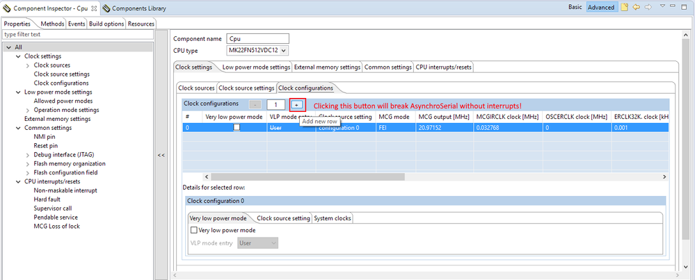

I have investigated the difference between your project and mine, and it seems that there is an issue with how AsynchroSerial or Serial_LDD behaves when multiple clock configurations are present. If there is a single clock configuration (as in your project) it behaves correctly. If there are multiple clock configurations (as in the default project template with the K22F board is selected in the new project wizard) then the receiver does not work.
If I press the "+" button in the clock configurations tab of Processor Expert and regenerate the code, then the receiver is broken. If I press the "-" button to delete the second clock configuration, then the receiver begins working again.
I am using KDS 3.2.0 with all updates applied.
I will delete other clock configurations in the meantime as a workaround.
