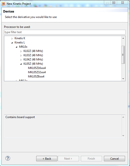

I am unable to create a project for KL05Z using KDS3.0 and KSDK1.3. I tried locating KSDK2.0 but looks like that is not available for download anymore.
We have customer hardware so as I understand the FRDM code may not be of help.Can you please help us get started with the KL05 device using KDS3.0?

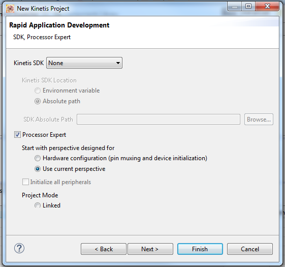

I checked my KDS3.2,  KL05 is listed
then , set Kinetis SDK as none.

Hello.
KSDK 1.3 doesn't include pe support for KL05.
However KDS itself includes KL05 pe support.
See attached video.
please make you you have the latest update installed.
