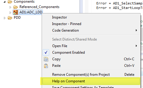

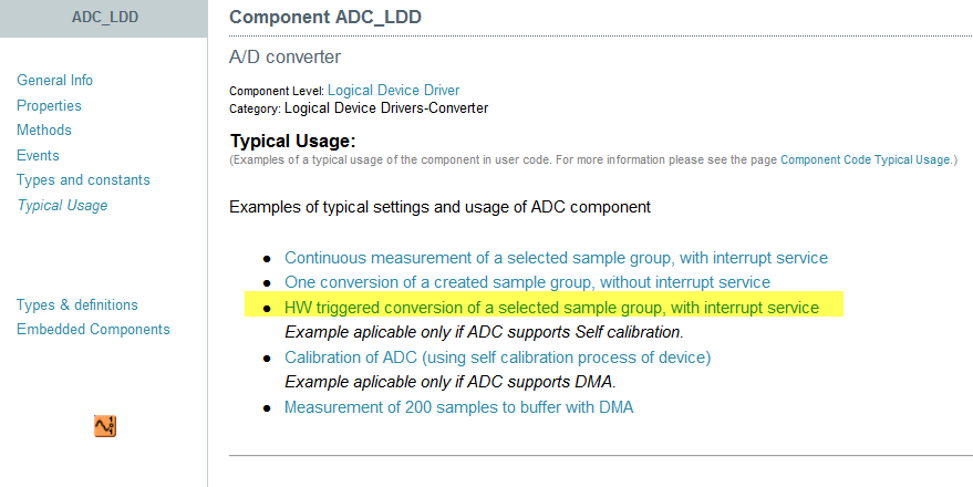

Carlos_Mendoza
Hi Rabbitz,
In your case it would be better to use the "StartLoopTriggeredMeasurement" method and configure the ADC to be triggered by the timer, you can use as reference the "HW triggered conversion of a selected sample group, with interrupt service" example included on the component help:
Hope it helps!
