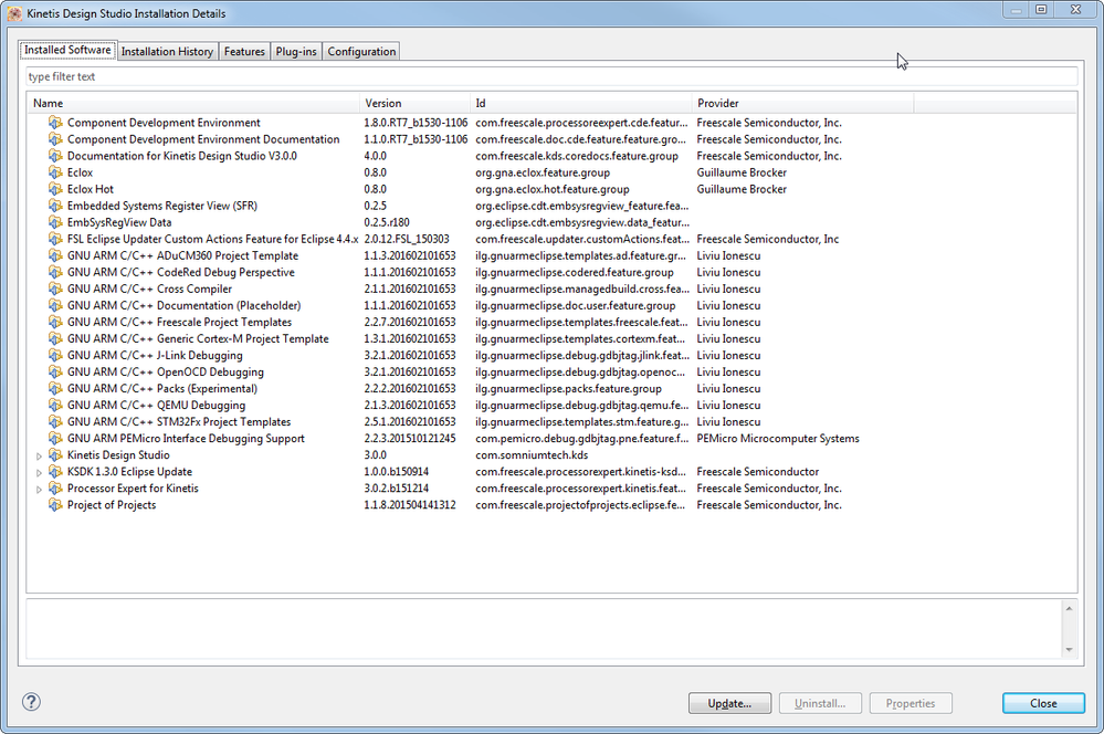

I have KDS 3.0.0 installed
and attempting install the update for Processor Expert for Kinetis 3.0.1 and I received the following error:
An error occurred while collecting items to be installed
session context was:(profile=DefaultProfile, phase=org.eclipse.equinox.internal.p2.engine.phases.Collect, operand=, action=).
No repository found containing: osgi.bundle,com.pemicro.core,1.1.43.201602211227
No repository found containing: osgi.bundle,com.pemicro.debug.gdbjtag.pne,2.3.6.201602211227
No repository found containing: osgi.bundle,com.somniumtech.branding.kds,3.1.0.201512141710
No repository found containing: osgi.bundle,ilg.gnuarmeclipse.debug.gdbjtag,2.2.2.201602101653
No repository found containing: osgi.bundle,ilg.gnuarmeclipse.managedbuild.cross,2.1.1.201602101653
No repository found containing: org.eclipse.update.feature,com.pemicro.debug.gdbjtag.pne.feature,2.3.6.201602211227
No repository found containing: org.eclipse.update.feature,com.somniumtech.kds.doc.releasenotes,3.1.0.201512141710
No repository found containing: binary,com.somniumtech.kds.executable.win32.win32.x86,3.1.0.201512141710
No repository found containing: org.eclipse.update.feature,com.somniumtech.kds,3.1.0.201512141710

Hello Terry,
You can refer this :
Kinetis Design Studio Update V3.1.0 available
Hope it hleps
