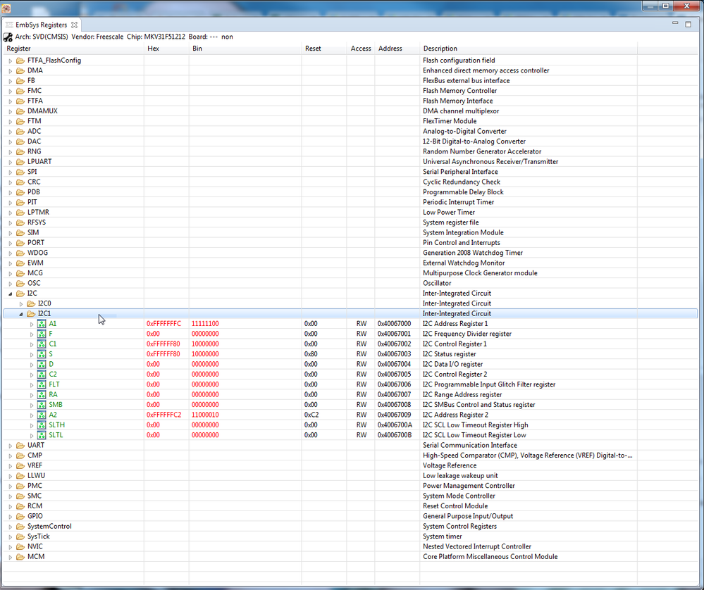

Hi Dave,
I've never used the "Peripherals" tab...now makes me wonder about it though.
I use the "EmbSys Registers" view to see the peripheral and system registers as the below huge picture shows.
Note I'm using a FRDM-KV31F as example but click on the "Arch" icon in upper left of the picture to switch MCU type.
Also when you open a peripheral "folder" one level.  Then double click to the right to open and active it.  Same to close it.  The Activation means that the debugger will request register updates each time you step or hit breakpoint.  So if using a slow debugger interface, having lots of peripheral register folders Activated (my words and terminology) will increase data back and forth and slow interface and debugging.

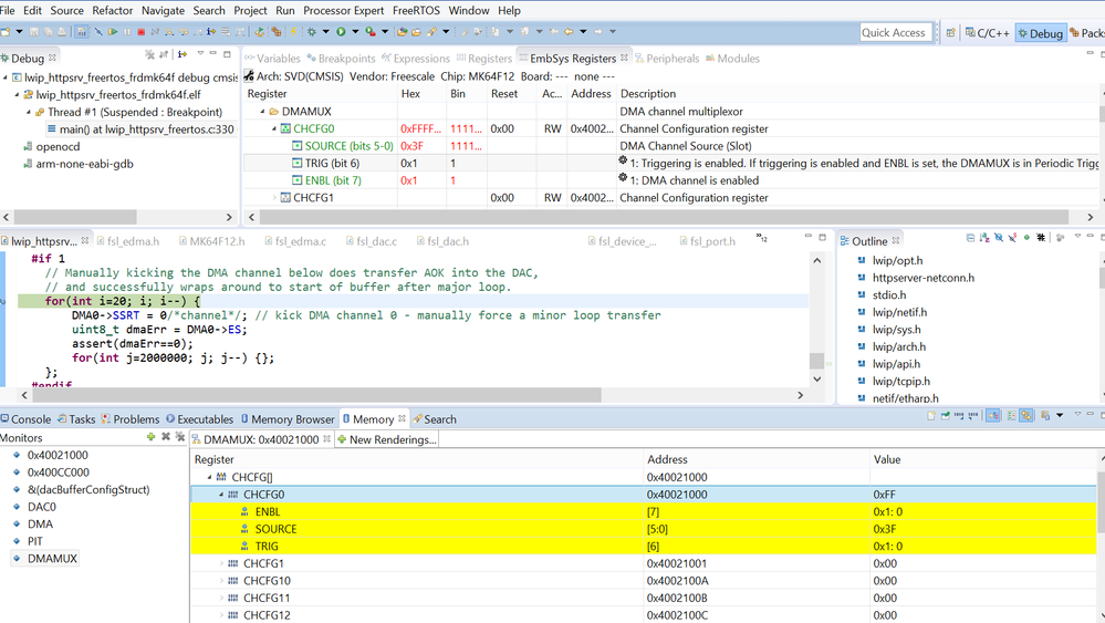

BlackNight
Hi Dave,
the Peripherals tab is part of the GNU ARM Eclipse plugins (The peripherals registers view ) and works with the CMSIS-Packs. Have a read at https://mcuoneclipse.com/2016/02/14/are-arm-cmsis-pack-the-future-of-software-components/

Selecting a peripheral using the The Packs Peripherals creates a "Memory Monitor". Unfortunately, it doesn't update properly during debugging. See below where the DMAMUX enable bit and trigger bit are shown (correctly) as set to 1 in the EmbSys view, but incorrectly as 0 in the monitor created via the Peripherals viewer. Bugs bugs bugs...

davenadler
Senior Contributor II
Thanks David, I never would have found the cryptic button to load the processor... So, the EmbSys Registerr viewer works, sort-of: For some reason the registers aren't organized logically! Instead of all the registers for one timer together, it shows all the load value registers for all timers, followed by the counter values... Barely usable for simpler peripherals like PIT, but utterly unusable for things like the DMA controller. Aaarrggg. Really unfortunate. I'll have to continue using the expression kludge, which is too bad because the EmbSys view shows the component bitfields whereas the FreeScale headers don't define these in the overlay structures.
