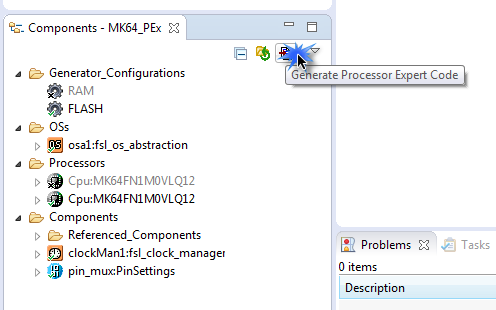

I created a Kinetis 1.3.0 project with processor expert. The build failed with error: /Static_Code/System/PE_low_level_init.c:51:31: fatal error: PE_low_level_init.h: No such file or directory

Hi MToM,
I was having the same issue and I solve it changing the Project Location. It seems that KIDS can't handle some characters ("ñ" in my case). To be sure I also used a really short route.

Hi Thomas,
Please make sure to generate the Processor Expert code before building the project:
Hope it helps!
