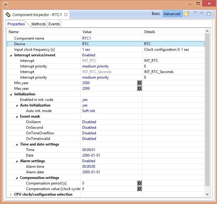

I seem to have come across an issue in KDS 1.1.0 with RTC_LDD component.
Am I missing something?
My target is MK20DX50 on FRDM-K20D50, and I've add component RTC_LDD.
It requires the RTC1 to be enabled, and in ComponentInspector.Methods, I click Enable - GenerateCode
The code it generates in RTC1.c looks like it is cut and pasted from another module and can;t work.
If I use RTC1_Enable(NULL); then it will use the NULL pointer without checking it.
If I try and create a  RTC1_TDeviceDataPtr its not declared in an available .h file
Instead I use
  RTC_PDD_EnableCounter(RTC_BASE_PTR, PDD_ENABLE);
which works.
RTC1.c:
LDD_TError RTC1_Enable(LDD_TDeviceData *DeviceDataPtr) {
  RTC1_TDeviceDataPtr DevDataPtr = (RTC1_TDeviceDataPtr)DeviceDataPtr;
  /* Device clock configuration test - this test can be disabled by setting
     the "Ignore speed mode test" property to the "yes" value in the "Configuration inspector" */
  if (!DevDataPtr->EnMode) {           /* Is the device disabled by user? */
    return ERR_SPEED;                  /* If yes then error */
  return ERR_OK;

neilhancock
Hello Zhang
I thought I had done what you asked for as a code snippet - but if you can't see a problem, I don't really care, as I have a workaround, just trying to point out what seems to me an error
If I enable the RTC with
RTC1_Enable(NULL);
I believe it will use the NULL pointer in a problem access.
I can't set up a valid pointer, as the RTC1_TDeviceDataPtr is in the RTC1.c file.
In the inspector - there isn't a " the 'Ignore speed mode test" property to the "yes" value in the "Configuration inspector" '
