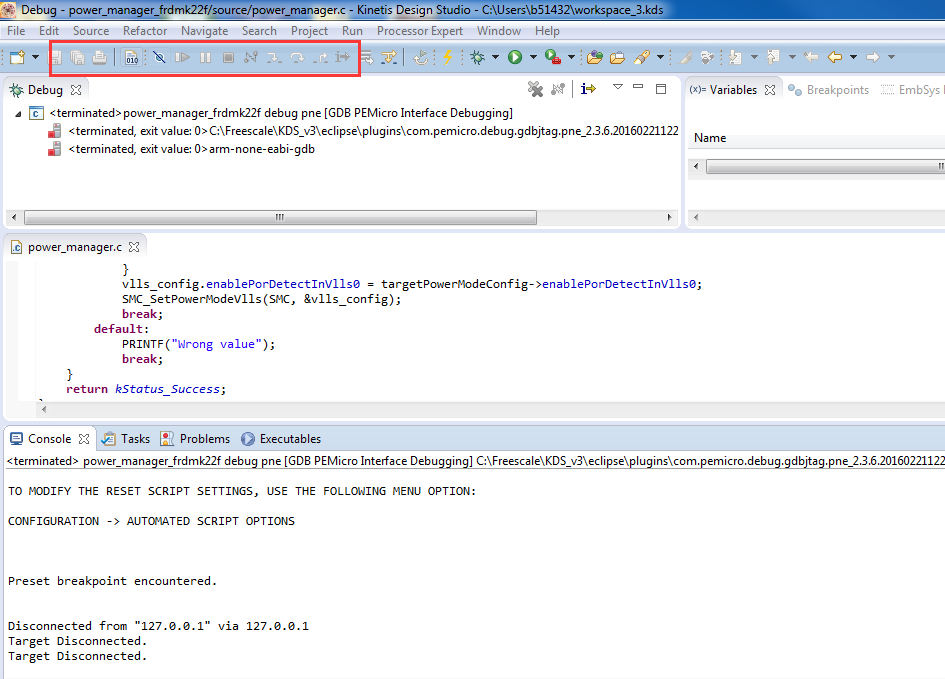

Hello Patrick,
 I have a test on my side, when run into VLLS1 mode, the KDS will disconnected .
all the debug buttons will be grey:
So in KDS, after exist from VLLS1 mode , we can not continue debug use KDS .
By the way, exist from VLLS1, it will reset , that is to say it will run from start ,
so I think it is the same for debug continue with reconnect by hand to debug .
