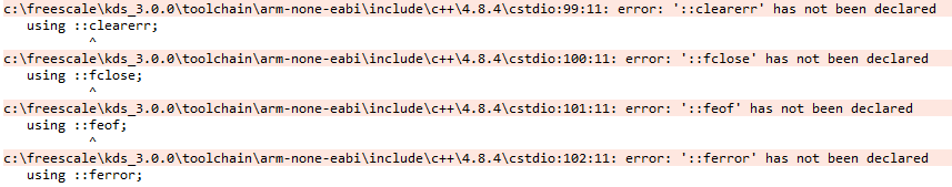

I am trying to get our software to compile on KDS.  We are using a Kinetis K70 processor and MQX.  Some of our code makes use of STL (the Standard Template Library), things like std::list and std::string.  However I keep on getting errors when I compile in KDS, similar to these:
Does anyone have an idea what the problem could be, or how I could get around these issues?

Hi Jim
STL is a software library for the C++ programming language, I think MQX projects need to be a little bit adapted to properly build with C++ code. You can refer to the attached document  Creating a New MQX Project Using GCC and C++.
